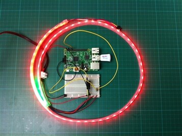

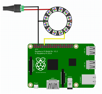

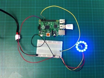

Hooking up the NeoPixels to the Raspberry Pi is extremely easy, just make sure the power supply used is properly rated for the number of NeoPixels you intend to use. For testing, I used a 5V/4A power supply to power the Pi and the NeoPixels (12 and 60 LEDs).
Make sure the ground signals of the NeoPixel strip/ring and the Raspberry Pi are connected. If they are not, the LEDs won't function properly and will light up in unpredictable patterns.
Even though the LED strip/ring operates at 5V and the Pi's GPIO at 3.3V, it appears that it is possible to drive the LEDs without having to use logic level conversion.
Demo
I tested two components:
  • an Adafruit NeoPixel ring with 12 LEDs
  • an addressable WS2811 60 LED strip from eBay
Both performed as expected using the sample script (strandtest.py), which I edited to configure the correct number of LEDs:

    the strip was bought on eBay a little more than a year ago. Search for WS2811/WS2812 LED strips, you'll find plenty variants with 30, 60 or more LEDs/meter.
    I know my setup bypasses the fuses and that's also why I didn't put it like that in the drawing. It's just something I quickly do when I don't have my microUSB power supply at hand. Thanks for looking out though image
