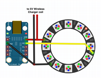

The Qi Wireless Charger was bought on eBay for a couple of euros. According to the specs, it is capable of outputting 5V/1A, which should be more than sufficient for this simple circuit.Connecting everything together is simple:
  • the coil's positive terminal is connected to the Trinket & NeoPixel USB+/PWR pins
  • the coil's negative terminal is connected to the Trinket & NeoPixel GND pins
  • the Trinket's #0 pin is connected to the NeoPixel IN pin

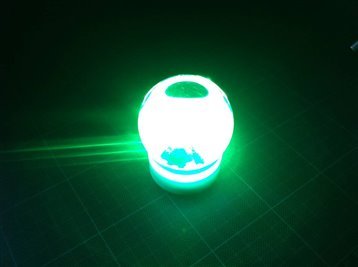

Below are some animated gifs (you may need to click to see the animation) showing a quick tests with the wireless charger first and then with the Trinket and NeoPixel Ring.

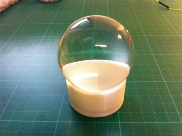

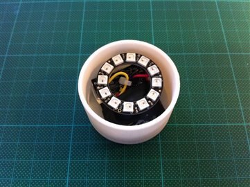

To hold the electronics, a simple housing is required. This can be done using a readily available container or can be custom created using cardboard, plastic, or even using 3D printing. I opted for the latter and created a simple hollow cylinder just big enough to hold all the parts. The wireless charger coil is at the bottom and the NeoPixel Ring at the top. I'm also using a crystal ball on top of the circuit to diffuse the light.
I hid the wireless charger base in the desk's surface, under my cutting mat. When the circuit is placed above the charger, it lights up without requiring a wired power source. Magic.
Because of the crystal ball sitting on top the NeoPixel Ring, some effects are also reflected on the ceiling, gradually changing color.
