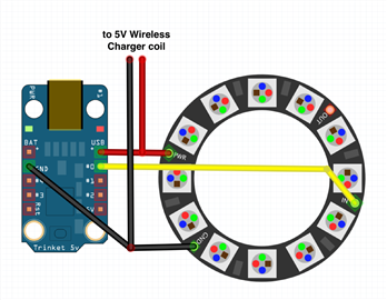

The idea for this little project is to have a lamp which can be turned on or off simply by moving it on a desk.
A wireless charging base is built into the desk's surface, and a circuit with microcontroller and LEDs gets powered wirelessly using the charging coil.
Components & Circuit
The electronic components used in this project are the following:
  • Adafruit Trinket 5V
  • Adafruit NeoPixel Ring with 12 LEDs
  • Qi Wireless Charger Base
  • Qi Wireless Charger Accept
The Qi Wireless Charger was bought on eBay for a couple of euros. According to the specs, it is capable of outputting 5V/1A, which should be more than sufficient for this simple circuit.Connecting everything together is simple:
  • the coil's positive terminal is connected to the Trinket & NeoPixel USB+/PWR pins
  • the coil's negative terminal is connected to the Trinket & NeoPixel GND pins
  • the Trinket's #0 pin is connected to the NeoPixel IN pin

    Me too Mark, my concern - as I am 100% ignorant on inductive chargers - is if this can work with higher powers or only for very low energy. I am fascinated by this method when I bought a super-cheap electrical toothbrush that charges wirelessly so it is totally waterproof.

    Your toothbrush is likely to be non intelligent, and is probably just the two halves of a transtormer in two seperate housings.

    I suspect Fredericks delay is the two parts negotiating and confirming their compatibility ..
  • fvan
    fvan over 11 years ago in reply to mcb1
    The delay is due to the Trinket not starting the program the first 10 seconds, checking if it is being programmed instead.
