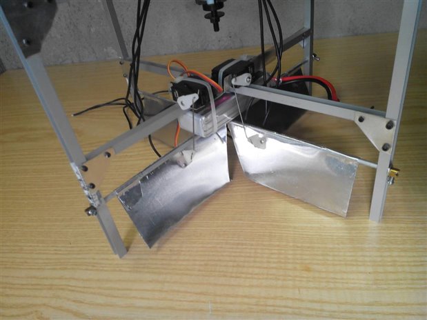

In my previous post I showed some photos of a frame made of steel wires. I found out this design to be absolutely faulty because it was not rigid enough to dampen vibration induces by motors and propellers.
So I started with a new frame frame made of U-shaped aluminum profiles. The final result is shown here
The U-shaped profiles are joined using 0.5 mm-thick aluminum sheet
At the bottom, two servos and the battery are located. The control surfaces are made with a 0.5mm aluminum sheet

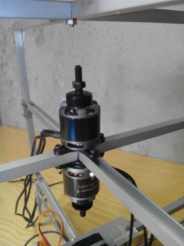

At the top, there is the Raspberry board. The board is mounted on a plywood base that should absorb vibrations, and kept in placed by four rubber rings ( as suggested by this tutorial)
Finally here is the counter-rotating motors

    amgalbu over 11 years ago in reply to screamingtiger +1
    Hi Joey The complete drone (including all the electronic components, batteries, etc) weighs 845 grams, which is much than I initially expect Cheers Ambrogio
  • amgalbu
    Hi Joey
    Cheers
    Ambrogio
  • screamingtiger
    screamingtiger over 11 years ago
    How much does that weigh?
