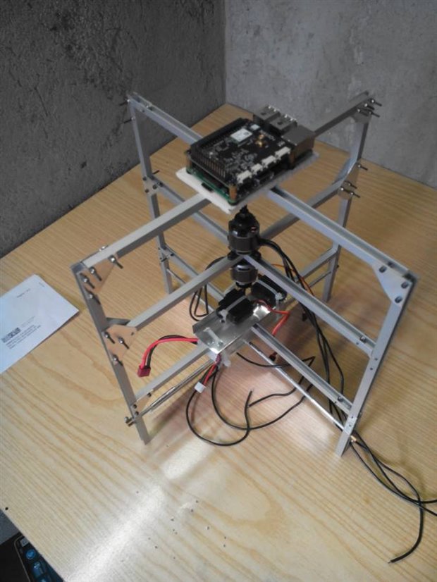

In my previous post I showed some photos of a frame made of steel wires. I found out this design to be absolutely faulty because it was not rigid enough to dampen vibration induces by motors and propellers.
So I started with a new frame frame made of U-shaped aluminum profiles. The final result is shown here
The U-shaped profiles are joined using 0.5 mm-thick aluminum sheet
At the bottom, two servos and the battery are located. The control surfaces are made with a 0.5mm aluminum sheet
At the top, there is the Raspberry board. The board is mounted on a plywood base that should absorb vibrations, and kept in placed by four rubber rings ( as suggested by this tutorial)
Finally here is the counter-rotating motors
Now I need to mount and connect all the electronic components (ESC, BEC, receiver)

    Hi Joey The complete drone (including all the electronic components, batteries, etc) weighs 845 grams, which is much than I initially expect Cheers Ambrogio
