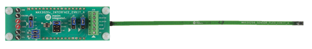

VitaRF is my entry for element14's Smart Home & Healthcare Challenge. I try to come up with an offbeat idea for these design challenges, but by the time I applied for the sponsored kit I was exhausted and just wrote the most obvious idea looking at what was in the kit - a wearable that reads body temperature and heart-rate/SpO₂ using Analog Devices sensors and gets that data into Home Assistant over BLE. I proposed the plan in two stages: get it working on the sensor boards + nRF52832 DK first, then shrink it onto a custom PCB second. That was before I got gifted an nRF54L15 kit as part of the How To Build A Smart Home Device With Matter webinar. Now that I know I'll soon have one in hand, I'm adding a third phase as a stretch goal: send this data over Matter. Details below.

I went through the datasheets for both sensors and their evaluation boards, and worked out how they actually operate - especially the flex cable pinout on the MAX30208.

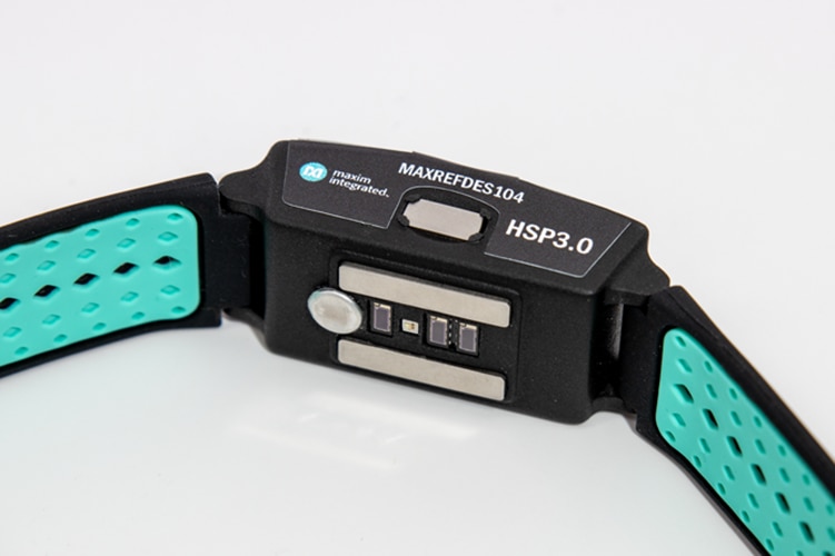

Nothing's actually been powered on yet - this first post is all phase-planning, datasheet reading, and locking in the power/LED architecture. I still need to figure out if I can use LabVIEW well enough. And, Worth a mention: ADI has their own reference design for this exact kind of thing, MAXREFDES104 -  a wrist-worn SpO₂/ECG/HR/temp platform that even uses the same MAX30208 from the Kit. Keeping it bookmarked as something to learn from as I go.
