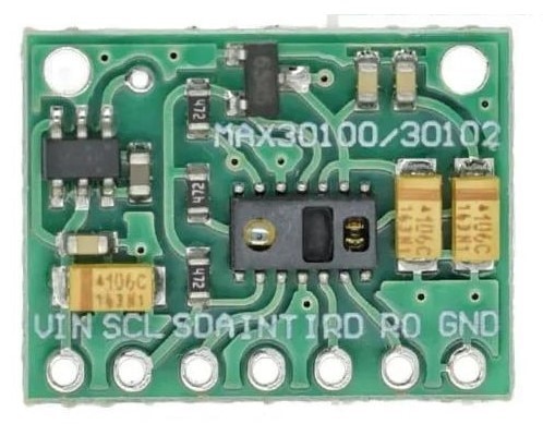

Generic MAX30102 breakout

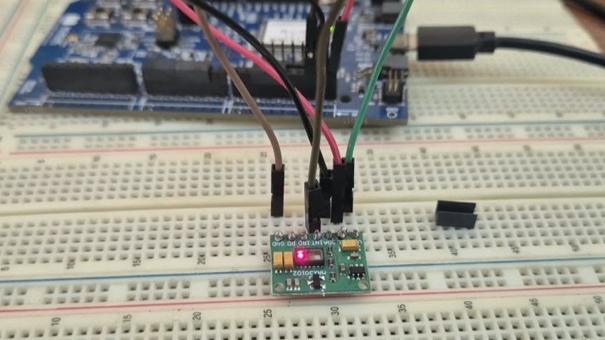

The sponsored kit is still on it's way, In-fact It is gonna be delivered tomorrow, but I had some spare time and a cheap generic MAX30102 breakout so started firmware bring-up early. Same underlying MAX30102 die as the MAXREFDES117, so It should work the same.
Pin Function Notes
VIN Power in 1.8–5V
GND Ground
SCL I²C clock to nRF52832 DK
SDA I²C data to nRF52832 DK
INT Interrupt output active-low, open-drain; needs a pull-up
IRD IR LED driver override Overrise Pin
RD Red LED driver override Override Pin
There was one minor difference - the breakout exposes two extra pins, IRD and RD, that the official MAXREFDES117 doesn't have at all. These are manual override test points wired straight to the chip's internal LED driver outputs, for bypassing the chip's own current control and driving the LEDs externally. Left both floating as per https://circuitdigest.com/microcontroller-projects/how-max30102-pulse-oximeter-and-heart-rate-sensor-works-and-how-to-interface-with-arduino

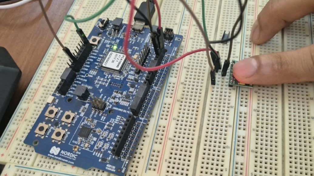

When the sensor is I2C, the easiest way to break ice is with an I2C Scanner, Thankfully, the sensor was not shy and responded ACK to my scan.

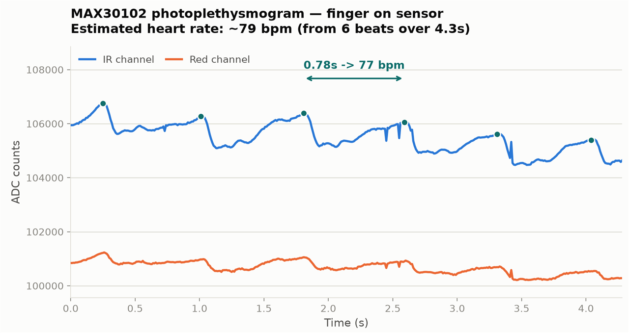

Then I wrote a register readback test: set LED1_PA (Red) and LED2_PA (IR) alternately, reading each register back after every write to confirm the write. Red flashing was visible by eye; IR was not visible, So I took it for granted.
Next was draining the sensor's FIFO continuously and logging raw Red/IR sample pairs. The raw PPG data streamed cleanly, and a plain peak-counting script on the captured trace estimated ~78 BPM

With finger on sensor: Sp02 locked at 98–100%, HR settling around 70–90 BPM which means I made productive use of the spare time.
