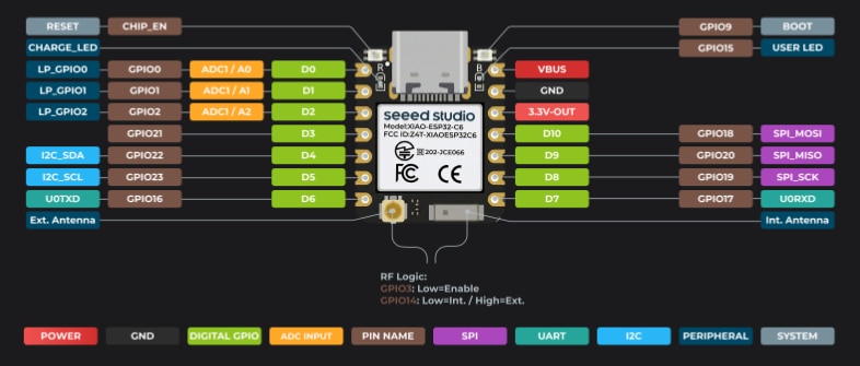

First thing: ESP32C6 pinout;
Xiao ESP32c6 pinout This picture is taken from the official Xiao site: Getting Started with Seeed Studio XIAO ESP32C6 | Seeed Studio Wiki
To use the built in I2C interface, we need to connect the MAX30100 to the following pins:
I2C SDA --> GPIO22 / D4
I2C SCL --> GPIO23 / D5

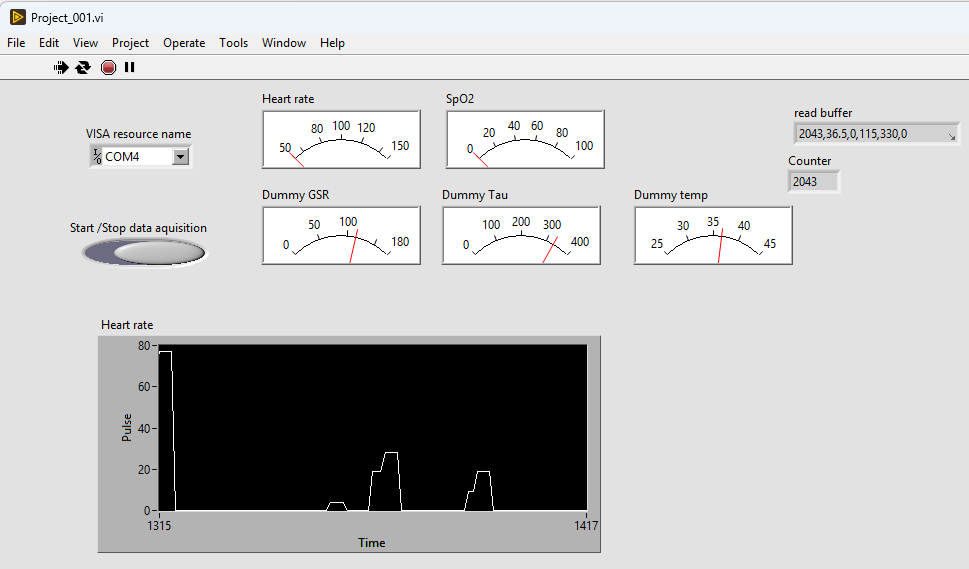

In LabView, I create a simple panel with some indicators; some of them are only for debugging and will be eliminated in the final instrument:
VI panel
How its working until now:
OBS: I have an issues with my MAX30100 sensor: the pull-up rezistors for I2C communication was not present on the sensor PCB and I have to add them using the soldering iron. After that, the sensor respond correctly to the I2C scanner (for address) and in the main loop.
