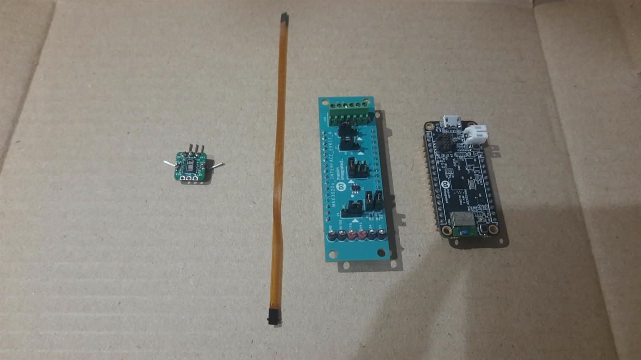

The Kit
(" The upper blue roll is the substitute for the thermal tape.
The role on the side is the 3M EM25TP-0050 EMI Absorber.
The big box is the Analog Devices MAX30208EVSYS# Evaluation Kit
 The Little black box is the Analog Devices MAXREFDES117# Reference Design Board")
This is the kit, I received it on 23rd but from them I spend time configuring them and in this forum I will show I come up with.
And By the way great thanks to Element14 for the swag :)
Configuring

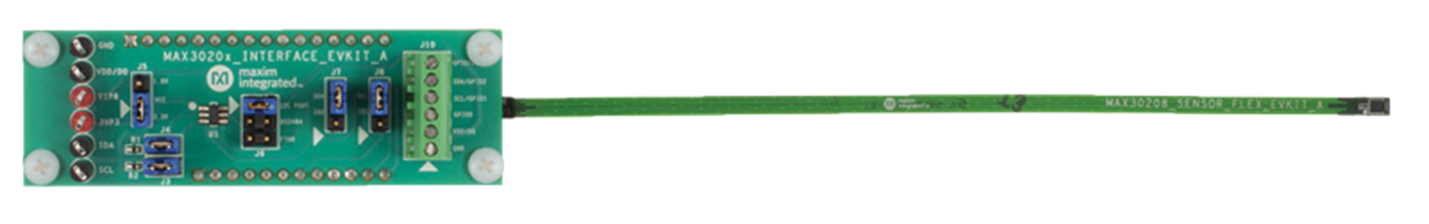

1) Analog Devices MAX30208EVSYS# Evaluation Kit:
This is the kit:
sorry for the size
Firstly I tested it with the pre-flashed  MAX32630FTHR MCU board, it was surprisingly easy put the MCU in the bottom of the board in J2 and J1, then put the flex ribbon in the J9. If you haven`t altered any caps to switch mode then it will work fine, and If you have messed them a bit. make sure.
Caps are put as in the image
Then go to https://www.analog.com/en/resources/evaluation-hardware-and-software/evaluation-boards-kits/max30208evsys.html#eb-overview and scroll down to bottom  and download the the tool.
And open, there is no need to install extra diver. And you will start seeing real time temperature readings Unfortunately the MCU get damaged(while I was testing it with the battery the battery socket had the opposite pins, and there was no diode  to protect the internals, I tried my best to find the real damage but nothing was seeming to work, and I decide to leave that for know and else use the Arduino UNO Q as the controller only. Disappointed )
Using it with our own platform
I was not able to find the frimware that come preinstalled in the MCU after spending the whole evening also.
But with the I had taken a screenshot of the registered address so I was able to reconstruct the sketch.
Else if your are using my code you do not need this to configure it.
Wire as shown(using J10):
GPIO1/3  -> EMPTY
SDA/GPIO2  -> To your MCU`s SDA
SCL/GPIO1 ->To your MCU`s SCL
VDD/DQ   -> 3.3v
GND -> GND

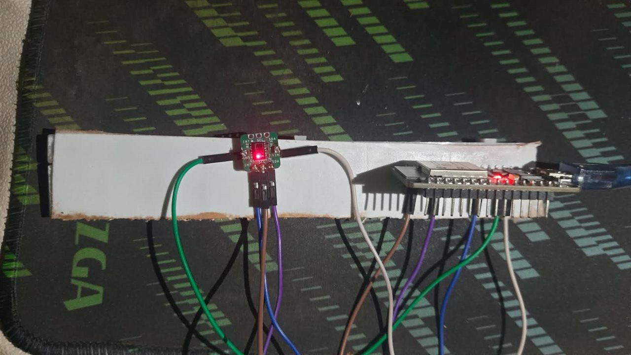

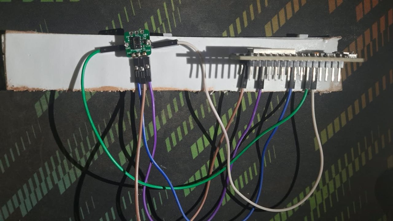

2) Analog devices  MAXREFDES117#
(in the left most side)
It was surprisingly tiny then expected, after soldering the headers its all done, then we have go to the software part.
The communication method is same as the MAX30208, I2C  so connection will be same as it.
GND -> GND
VIN -> 3.3v or 5v (due to the  onboard logic level translator)
SCL -> SCL
SDA -> SDA
INT-> To any gpio you want , I am using 4
the setup
Firstly I tried to get raw data out of the sensor.
The code:

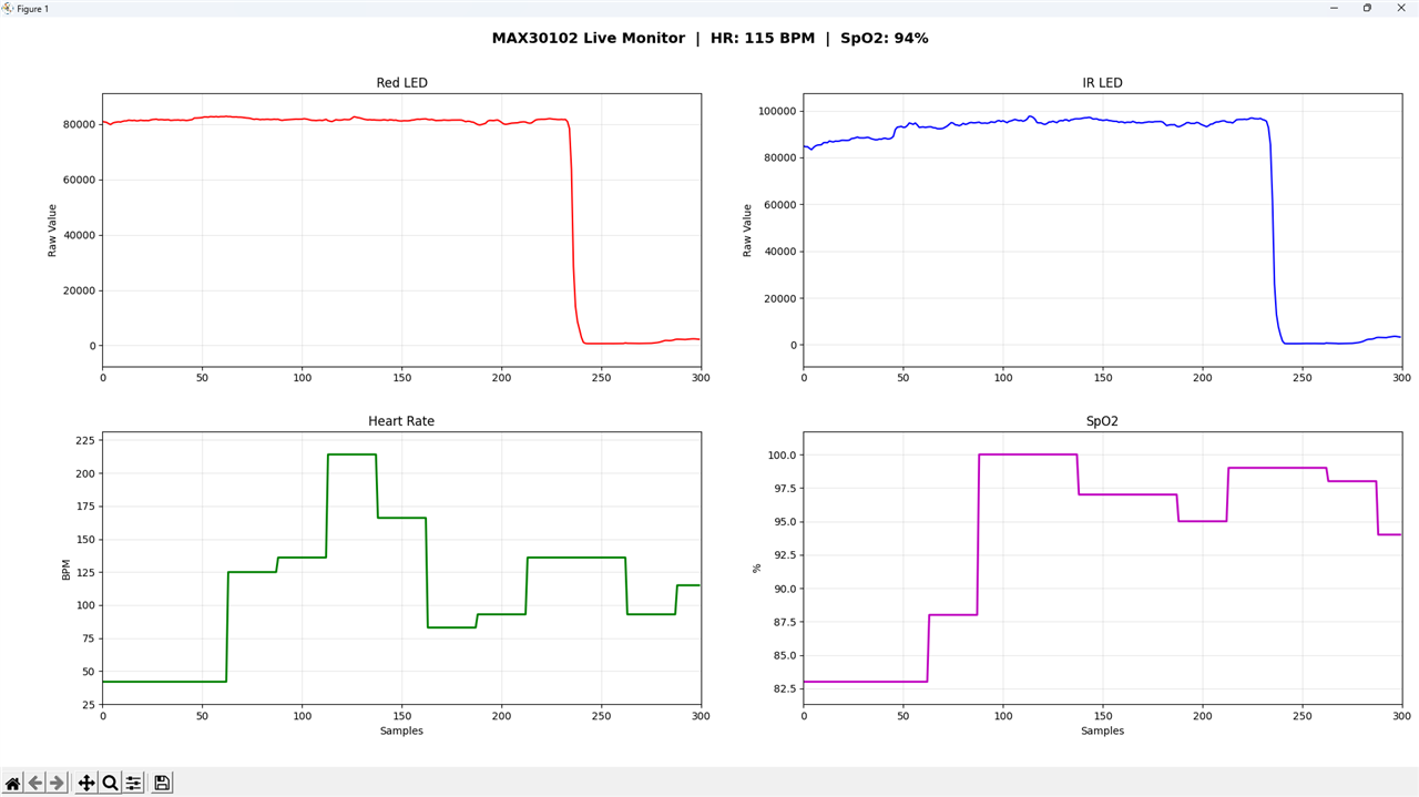

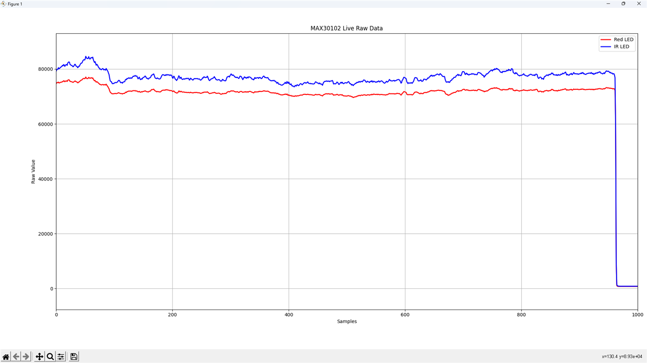

After uploading you would see the red led on the sensor glowing, don`t worry if you wire all up and it doesn`t glow because it requires I2C command.
These are the results:
Red: 59081	IR: 53063
Red: 52519	IR: 48219
Red: 58457	IR: 53900
Red: 67719	IR: 62305
Red: 72758	IR: 66136
Red: 71056	IR: 64256
Red: 73083	IR: 66650
Red: 79899	IR: 73915
Red: 87685	IR: 83919
Red: 92788	IR: 91199
Red: 92413	IR: 90605

They differ from the distance from the sensor  and movement of the object relative to the sensor.
This graph shows the noise signal(when the sensor is let undisturbed with nothing in its way)
(DAB I tried using py this time to plot the graph.)
This graph shows readings when the finger is placed with the least possible movement.

These are the readings :      (I tried my best to make keep my finger consistent but there was still a little bit shake, so I was not able to achieve high accuracy, I will improve this in the upcoming posts.)
