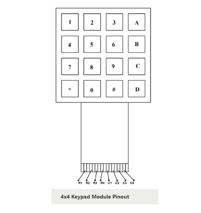

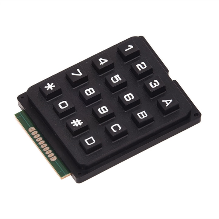

For my ID Card device i need a way to enter the pin in order to unlock it, I initially thought of a membrane keyboard, but in my box of electronics treasure, I found an tactile keyboard which  i had bought before from Robu: https://robu.in/product/4x4-matrix-16-keyboard-keypad/  and an datasheet attached to it.
But when i tried with the code, it was not working well, the letter orientation came such that it seemed the rows and columns were transposed. Swapping the pins for Rows and Columns worked. Confusion set it, is my simple enough code wrong? Revelation set in when Adafruit's learning page showed the correct pin out here: https://learn.adafruit.com/matrix-keypad/pinouts . My Code is right, the datasheet was wrong. Here is the correct one
Photo Credits: Adafruit  (Do note my code uses C0~C3 instead of C1~C4) and similarly for the Rows
Working of Keypad
The working of keypad is an age old and proven mechanism. Each key is a switch, one side of the switch is wired along the column and the other side is wired along the row. When switch is pressed, it connects the respective column to the row. To detect the key pressed, we wire the 4 Row and 4 Columns pins to GPIO
  1. All the Rows are made input without any pull-ups / pull downs (HiZ - High impedance). The Columns are made input with pull ups
  2. One Row (lets saw R1) is driven low and the 4 columns are read to see which one is low. The column corresponding to the key pressed will be low.
  3. If no Column is found to be low, the next Row is made low after restoring the previous row to HiZ
  4. If all rows are scanned and no columns are found low, then it means no key is pressed
When One key is found to be pressed, It is saved in key and last key. During the next round of scan if the same key is found to be still pressed, it is ignored. This way i have implemented a simple hold detection.  This happens until the the scan finds no key pressed, but last key is set, this signals a key release event, and last_key is set as none. a 10ms interval between scans should be sufficient for the de-bouncing delay. If you don't know what de-bouncing is check out https://www.picotech.com/library/articles/blog/what-is-switch-bounce-how-to-implement-debounce
In my implementation of this as a function - keypad_scan() it returns an integer such that the number starts from 0 and increases as keys go from top to bottom and left to right. This way i can quickly compare the pressed key to the last one in one statement, plus also is easier to debug in case a key / row / column is not working
1=0   2=1   3=2   A=3
4=4   5=5   6=6   B=7
7=8   8=9   9=10  C=11
*=12  0=13  #=14  D=15

Keypad Wiring
Signal Pin
KPD_ROW0 P5_0
KPD_ROW1 P5_1
KPD_ROW2 P5_2
KPD_ROW3 P5_3
KPD_COL0 P5_4
KPD_COL1 P5_6
KPD_COL2 P3_2
KPD_COL3 P3_3
