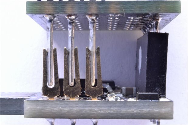

    I did this with a simple extension (I think it was the two smaller ones.)
    http://www.element14.com/community/people/Problemchild/blog/2013/08/03/macro--the-art-of-seeing-clearly#comment-24980
    This was 1/3 sec at probably F8 using natural light but reflected off a white reflector.
    By contrast this was 20s at probably f22 and not so much light.
