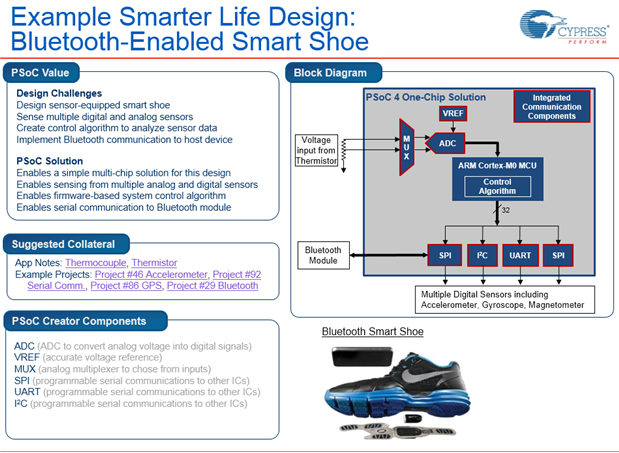

I found that no one from the selected 15th participants was decided to go for any of the three proposed ideas from the main post of the PSoC 4 Smarter Life Design Challenge.
Now think about it if you will see at least one of this proposed project in this Design Challenge I think you will like that.
And guess again yes you are right I decided to join the contest with proposed project "Bluetooth-Enabled Smart Shoe".
I will based on the main block diagram so I copy paste it here and will come in the next post with more clear details of what I will plan to do.

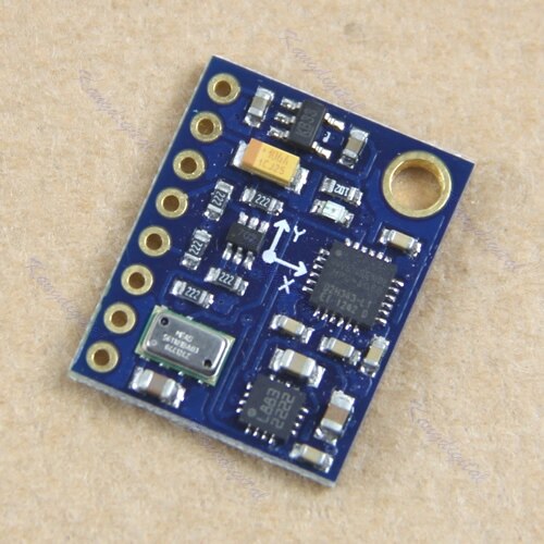

So today I want to present the modified block diagram as you can see below.

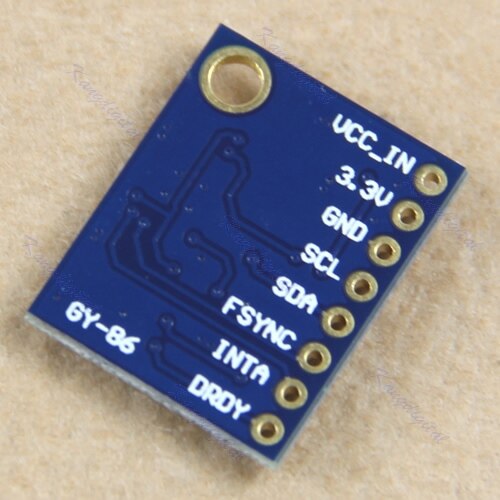

1. The Thermistor was removed because the obtained module with GY-86 includes the following sensors:
3-axis gyroscope + triaxial accelerometer + three-axis magnetic field +  pressure/altimeter + temperature.
These 3 IC are: MPU6050 + HMC5883L + MS5611. All these sensors will be accessed through I2C bus.
This GY-86 module cost: £10.79 and was ordered from ebay here: 1PC 10DOF IMU MS5611 HMC5883L MPU6050 MWC Flight Control Sensor Module | eBay

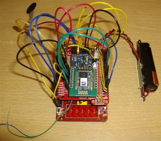

4. The RGB LED with a push button will be used from the PSoCRegistered 4 Pioneer Kit.
For all other components which are not exist on PSoCRegistered 4 Pioneer Kit will be soldered to the Arduino ProtoShield Kit.
This component cost £12.48 and was ordered from here Cool Components Arduino ProtoShield Kit
Obviously there much cheaper option for Arduino ProtoShield Kit from other online shop, but I decide to order everything from one place in order to save on cost delivery.
5. Finally the hardware component closed with the single 1xAA battery holder. This is nice option because it pre-include the circuit of DC to DC Step Up for 5V.
This component cost £8.21 and was ordered here Cool Components 5V DC to DC Step Up - 1xAA

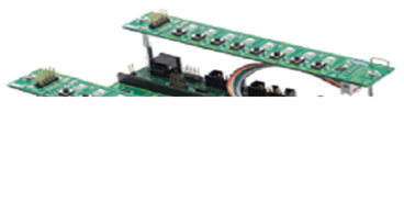

I decided to view this video The Cypress PSoC 4 and the Smarter Life
and also quickly scroll through all these documentations PSoC 4 Pioneer Kit

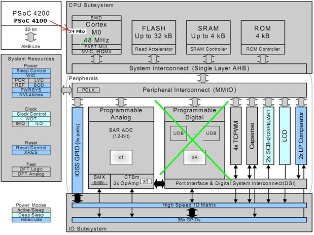

The firmware on PSoCRegistered 4 Pioneer Kit which include the PSoC4200 will be written in order to been compatible with PSoC4100 family.
Why? So let go for quick explanation. As you can see below the figure 3 the main differences are:
  • The clock frequency is higher in PSoC4200 (48MHz) comparing to the PSoC4100 (24Mhz)
  • The PSoC4200 have 4 additional programmable UDB blocks
So the requirement in the block diagram of figure 2 are:
  1. x1 UART can be used through SCB
  2. x1 I2C can be used through SCB
  3. x1 OpAmp
  4. x1 12bit ADC
  5. x3 PWM for RGB LED can be used through TCPWM
  6. Few GPIO for button and other IC
These generally mean that for high volume production where each penny is matter the implementation of this project
on PSoC4100 will provide a lot of saving and obvious increase the total income.
This was the main reason why I will plan to use 24MHz and no any UDB on the PSoC4200.

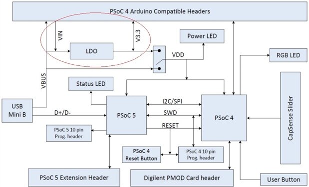

As it was pointed in figure 2. I planning to use 1.5V AA battery. The ordered battery holder include the DC to DC Step Up regulator at 5V.
Now I am planning to create only the prototype for this "PSoC 4 Smarter Life Design Challenge" and not the final production PCB in super duper tiny design, mainly because I have not get any offer from shoe manufacturer yet ))), but also because of short time which I have before the dead line. It is good to see how some of the shoe manufacturer will react to this implementation but also as DAB was mentioned there maybe other companies who will willing to create that design and go out to the market. I will be here for offers )))
So to come back to the theme I am saying that based on the extracted image of the PSoCRegistered 4 Pioneer Kit we can see that it has internal regulator at 3.3V as it show the below figure 4.
These will be a source of power for all components on the circuit including the Bluetooth module which may operate in 2.9V to 3.4V

Finally because the PSoCRegistered 4 Pioneer Kit include PSoC5 and many other circuits the current leak will be obviously higher than 81.73mA
For this reason the development and debug will be run through USB and by full completion of the software I will disconnect the PSoCRegistered 4 Pioneer Kit and will use this custom SSOP28 adapter in figure 5 with 28pin SSOP MCU.

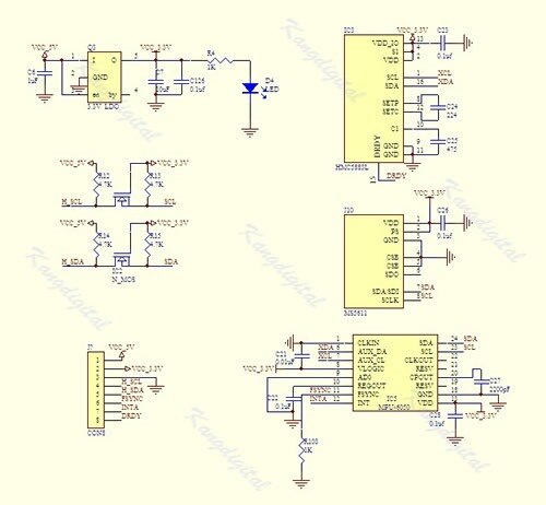

The schematic of the sensor board is showing in the below figure 6 and both side of that PCB showing in the figures 7a and 7b.
Figure 6. Schematic of Sensors board

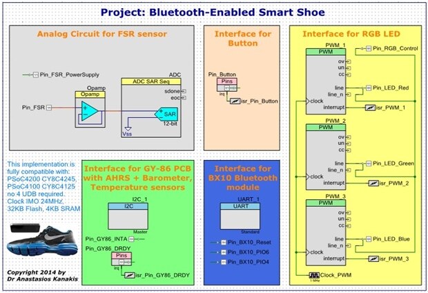

The figure 8 is present the schematic of this project. The advantage of this implementation as it was mentioned before
is to make it work on both PSoC4100 and PSoC4200 because no any of the 4 UDB was required.

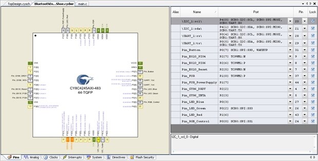

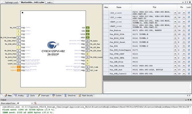

The pins map for TQFP44 and SSOP28 are presented in figure 9 and figure 10 accordingly. As you can see the UART_1 moved it pins from P0_4 -> P3_0 and P0_5 -> P3_1 and also
the Pin_LED_Red from P1_6 -> P0_6. This is because PSoCRegistered 4 Pioneer Kit have the Red led pin on P1_6 and the UART pins on P3_0 with P3_1 was used between PSoC5LP.
So for custom PCB using board from above figure 5 the pins map can be used as it show the below figure 10.
Figure 9. The TQFP44 pins map for PSoC4200 on the PSoCRegistered 4 Pioneer Kit.
Figure 10. The pins map for PSoC4100 CY8C4125PVI-482.

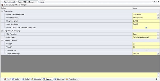

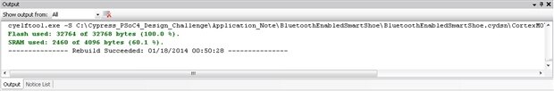

As you can see the total size of used Flash and SRAM with settings for ARM GCC Compiler 4.7.3 and optimization option -Os (Size) and newlib-nano enabled gives below result:
Flash used: 1294 of 32768 bytes (3.9 %).
SRAM used: 1532 of 4096 bytes (37.4 %).
The increased size of SRAM is because by default the heap size and stack size was set to be 0x0100 and 0x0400 accordingly as it show the below figure 11. This will required 0x0500 = 1280 bytes. The rest of couple of hundred bytes was need for the PSoC4 library.
Figure 11. PSoC4 system settings.

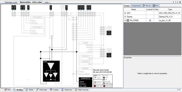

The analog map is showing in figure 12 below:
Figure 12. PSoC4 analog in PSoC4100.

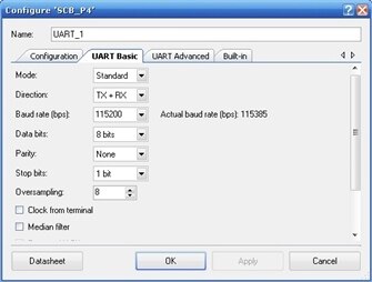

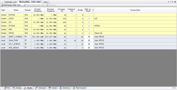

The clock settings is showing in the below figure 13. The UART for Bluetooth module use 115200 baud rate. The 3 TCPWM for RGB LED 1MHz with 10000 step for overflow which gives 100Hz refresh rate. The intensity of the light led is adjusted by the compare value. This is very critical for having long battery life instead of just using the single three GPIO for LED. By switch the LED power in 100Hz with custom duty cycle is possible to save more energy from x2 if (duty cycle is 50% to x10 or x100 if continue to reduce the duty cycle.
The next clock is for default standard I2C data rate of 100Kbps. Finally the analog part used for 12bit SAR ADC clock of 4MHz.
Figure 13. Clocks on PSoC4.

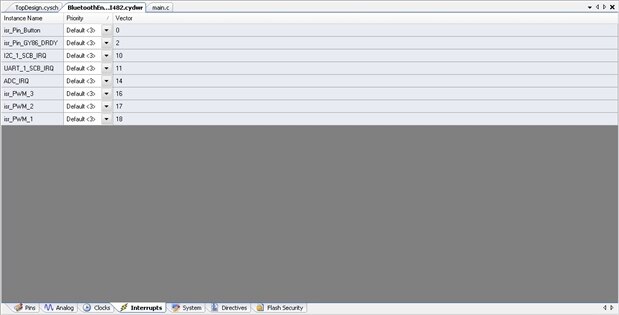

Last but not least for today I want to show the all used interrupts in the PSoC4 as it show the below figure 14.
Figure 14. All Interrupts which available in this project
More description about schematic will be done in next day.
See you soon )

Before I will move to the source code description I want to complete with settings for the PSoC4 as it show the figure 8 but also the main system clocks as well.
Starting from the main system clocks I have setup it as it show the below figure:

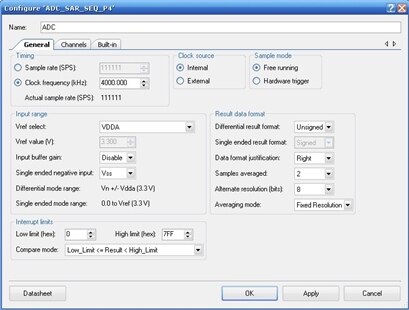

The ADC was set to 11-bit resolution as:

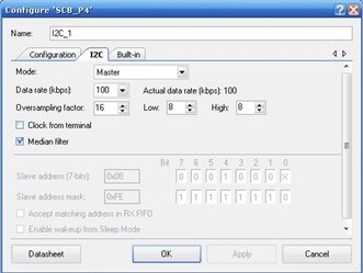

For Interface for GY-86 PCB with 3-axis Accelerometer +  3-axis Gyroscope + 3-axis Magnetometer + Barometer/Altimeter + Temperature sensors
The I2C_1 was set as it show below figure, if higher Date rate will need then 100Kbps can be changed to 400Kbps very easy:

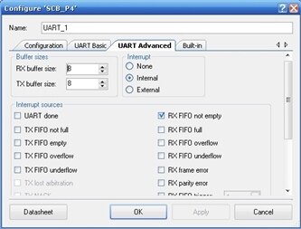

For BX10 Bluetooth module interface I used:
The UART_1 was set as:

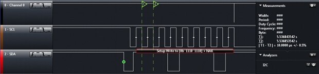

Last week I complete the library for GY-86 and test all the hardware apart from GY-86 which left for the last hardware block.
The sensors library integrate also sensors fusion algorithm for different error compensation and also use quaternions which not suffer from "Gimbal lock" because use 4 dimension orientation instead of 3.
The PSoC4 also calculate the Pitch,Roll and Yaw and offload the external device such as mobile phone to do all sort of calculation which 32bit Cortex-M0 easy able to do it.
Everything seems to be fine, but when I start working with received GY-86 PCB from ebay I was unlucky to manage to communicate with MS5611.
I attached the snapshot from logic analyzer and as you can see I am not getting ACK from the device.
I tried many different senarios such as power up it from separate LDO regulator, trigger SCL line multiple times for unlock the possible freeze on SDA and some other tricks but the IC MS5611 is not respond.
I decide to change 2K2 resistor to 4K7 and also unsolder the dual MOSFET and bridge properly the SCL and SDA but again no any light.
Just thinking to unsolder the MS5611 from the board to see if I can at least to communicate with MPU6050 which this also do not reply. The only IC which seems to work on the board is HMC5883 which gives the DDRY output.
So here in figure 15 is the problem with ACK which I am not getting it.
Figure 15. MS5611 no ACK.
If I will have a luck and the GY-86 will work without the MS5611 sensor then I will upload the project and photos with video.

After identification of the problem with GY-86 PCB for which I lose few days. Finally want to report that this PCB works fine, but SCL and SDA pins are flipped, so be careful )
The source code of PSoC4 "Bluetooth-Enabled Smart Shoe" is completed successfully! )))
I also updated the I2C bus rate from standard of 100kbps to 400kbps which optimized for the performance.
The source code was used all 100% from the MCU Flash memory as you can see from the below image 16.
Figure 16. The PSoC4 32KB Flash was used 100% )))

Here we go. This is a prototype image on figure 17 of my project.
Figure 17. Prototype of the Bluetooth-Enabled Smart Shoe.
This is the demonstration of Bluetooth connectivity with PC through RFCOMM link where you can see how ASCII and HEX mode are works with transmission of all sensors data and calculated values for quaternions, Pitch, Roll and Yaw and Euler Angles as well. Plus this FSR value which is reading through SAR ADC, which changing from 0 value to higher numbers when I pressing the sensor area.

    e14 Contributor over 12 years ago in reply to DAB
    Hi DAB,
    No the GY-86 turn to work properly but the SCL and SDA are wrongly typed.
    I was think the same as you, but after the soldering the MS5611 and playing with MPU6050 just decide to try to flip SCL and SDA pins and was surprisingly shocked by viewing that is working )))
    Ufff, I pass from the hell to come to the paradise )))

    DAB over 12 years ago in reply to e14 Contributor
    I wonder if you got a counterfeit part or if it came from the manufacturer mislabeled?
    I would contact the manufacturer to see if they are aware of the issue.
