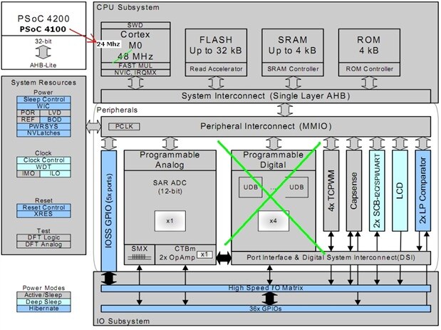

Why? So let go for quick explanation. As you can see below the figure 3 the main differences are:
  • The clock frequency is higher in PSoC4200 (48MHz) comparing to the PSoC4100 (24Mhz)
  • The PSoC4200 have 4 additional programmable UDB blocks
So the requirement in the block diagram of figure 2 are:
  1. x1 UART can be used through SCB
  2. x1 I2C can be used through SCB
  3. x1 OpAmp
  4. x1 12bit ADC
  5. x3 PWM for RGB LED can be used through TCPWM
  6. Few GPIO for button and other IC
These generally mean that for high volume production where each penny is matter the implementation of this project
on PSoC4100 will provide a lot of saving and obvious increase the total income.
This was the main reason why I will plan to use 24MHz and no any UDB on the PSoC4200.

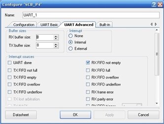

For BX10 Bluetooth module interface I used:
The UART_1 was set as:
The Pin_BX10_PIOx were set as: Digital Input, Strong Drive with low state and Fast Slew rate.
