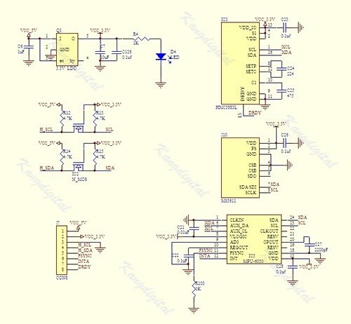

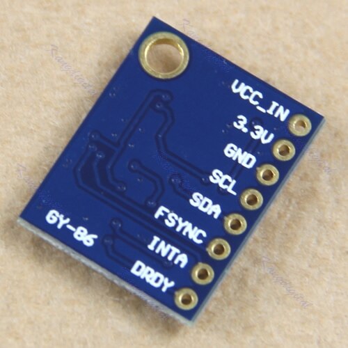

So today I want to present the modified block diagram as you can see below.

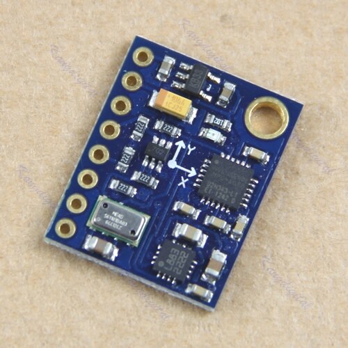

1. The Thermistor was removed because the obtained module with GY-86 includes the following sensors:
3-axis gyroscope + triaxial accelerometer + three-axis magnetic field +  pressure/altimeter + temperature.
These 3 IC are: MPU6050 + HMC5883L + MS5611. All these sensors will be accessed through I2C bus.
This GY-86 module cost: £10.79 and was ordered from ebay here: 1PC 10DOF IMU MS5611 HMC5883L MPU6050 MWC Flight Control Sensor Module | eBay

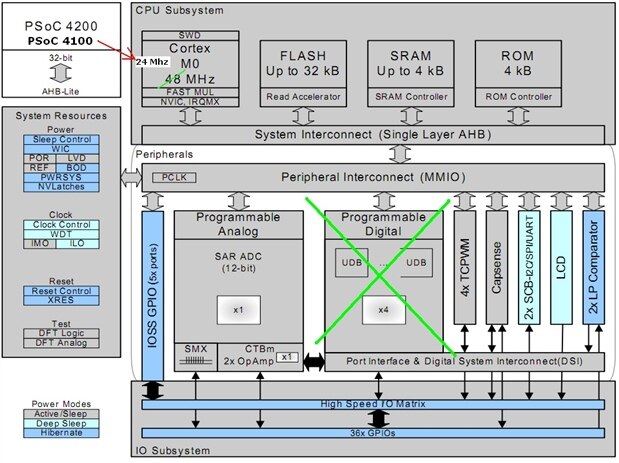

The firmware on PSoCRegistered 4 Pioneer Kit which include the PSoC4200 will be written in order to been compatible with PSoC4100 family.
Why? So let go for quick explanation. As you can see below the figure 3 the main differences are:
  • The clock frequency is higher in PSoC4200 (48MHz) comparing to the PSoC4100 (24Mhz)
  • The PSoC4200 have 4 additional programmable UDB blocks
So the requirement in the block diagram of figure 2 are:
  1. x1 UART can be used through SCB
  2. x1 I2C can be used through SCB
  3. x1 OpAmp
  4. x1 12bit ADC
  5. x3 PWM for RGB LED can be used through TCPWM
  6. Few GPIO for button and other IC
These generally mean that for high volume production where each penny is matter the implementation of this project
on PSoC4100 will provide a lot of saving and obvious increase the total income.
This was the main reason why I will plan to use 24MHz and no any UDB on the PSoC4200.

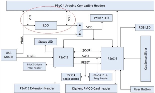

As it was pointed in figure 2. I planning to use 1.5V AA battery. The ordered battery holder include the DC to DC Step Up regulator at 5V.
Now I am planning to create only the prototype for this "PSoC 4 Smarter Life Design Challenge" and not the final production PCB in super duper tiny design, mainly because I have not get any offer from shoe manufacturer yet ))), but also because of short time which I have before the dead line. It is good to see how some of the shoe manufacturer will react to this implementation but also as DAB was mentioned there maybe other companies who will willing to create that design and go out to the market. I will be here for offers )))
So to come back to the theme I am saying that based on the extracted image of the PSoCRegistered 4 Pioneer Kit we can see that it has internal regulator at 3.3V as it show the below figure 4.
These will be a source of power for all components on the circuit including the Bluetooth module which may operate in 2.9V to 3.4V

The Sensors board include the following there sensors: MPU6050 + HMC5883L + MS5611
1. The MPU6050 which is 3-axis Gyroscope with 3-axis Accelerometer required 3.8mA (I will not use internal DMP so it will be disabled, but even if it will be enabled the total current consumption will be 3.9mA)
     So this 3.8mA value is for both Gyro + Accel Enabled.
2. The HMC5883L which is 3-axis Magnetometer consume 100uA=0.1mA in normal mode and 2uA in idle. Sounds good.
3. The MS5611 which is Barometric Pressure Sensor with Temperature Sensor consume 1uA, but have maximum peak current of 1.4mA during conversion.

Finally because the PSoCRegistered 4 Pioneer Kit include PSoC5 and many other circuits the current leak will be obviously higher than 81.73mA
For this reason the development and debug will be run through USB and by full completion of the software I will disconnect the PSoCRegistered 4 Pioneer Kit and will use this custom SSOP28 adapter in figure 5 with 28pin SSOP MCU.

The schematic of the sensor board is showing in the below figure 6 and both side of that PCB showing in the figures 7a and 7b.
Figure 6. Schematic of Sensors board

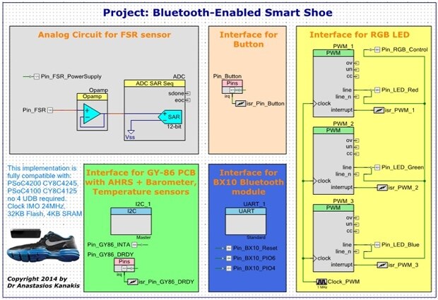

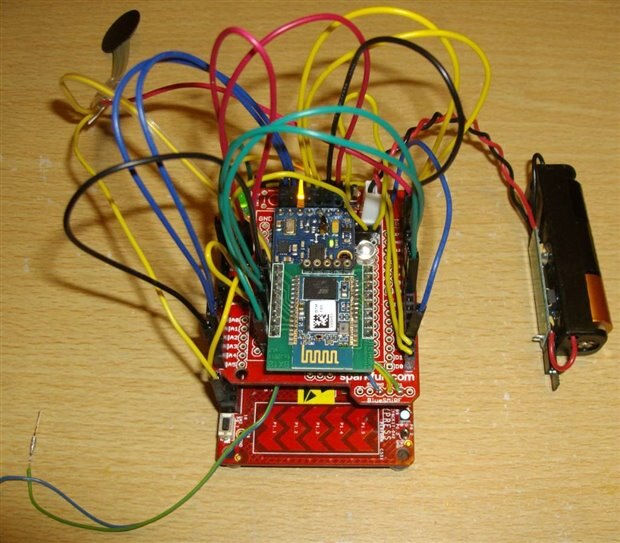

Few days ago received the PSoCRegistered 4 Pioneer Kit and start the embedded development.
Today I will show you step by step the internal components implementation on PSoC4.
The figure 8 is present the schematic of this project. The advantage of this implementation as it was mentioned before
is to make it work on both PSoC4100 and PSoC4200 because no any of the 4 UDB was required.
Figure 8. The Schematic on PSoC4

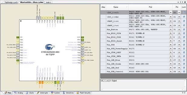

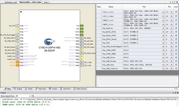

The pins map for TQFP44 and SSOP28 are presented in figure 9 and figure 10 accordingly. As you can see the UART_1 moved it pins from P0_4 -> P3_0 and P0_5 -> P3_1 and also
the Pin_LED_Red from P1_6 -> P0_6. This is because PSoCRegistered 4 Pioneer Kit have the Red led pin on P1_6 and the UART pins on P3_0 with P3_1 was used between PSoC5LP.
So for custom PCB using board from above figure 5 the pins map can be used as it show the below figure 10.
Figure 9. The TQFP44 pins map for PSoC4200 on the PSoCRegistered 4 Pioneer Kit.
Figure 10. The pins map for PSoC4100 CY8C4125PVI-482.

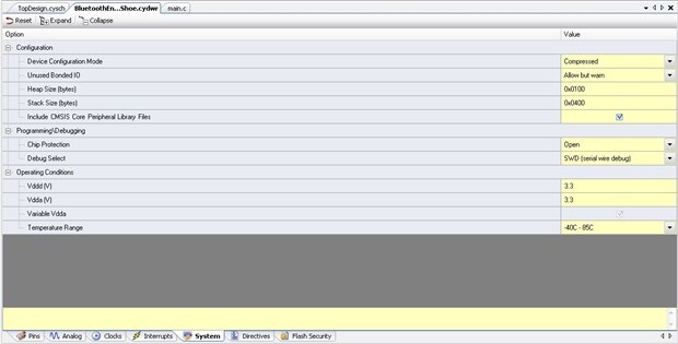

As you can see the total size of used Flash and SRAM with settings for ARM GCC Compiler 4.7.3 and optimization option -Os (Size) and newlib-nano enabled gives below result:
Flash used: 1294 of 32768 bytes (3.9 %).
SRAM used: 1532 of 4096 bytes (37.4 %).
The increased size of SRAM is because by default the heap size and stack size was set to be 0x0100 and 0x0400 accordingly as it show the below figure 11. This will required 0x0500 = 1280 bytes. The rest of couple of hundred bytes was need for the PSoC4 library.
Figure 11. PSoC4 system settings.

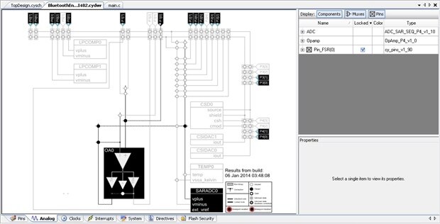

The analog map is showing in figure 12 below:
Figure 12. PSoC4 analog in PSoC4100.

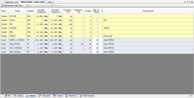

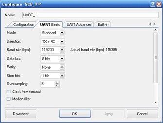

The clock settings is showing in the below figure 13. The UART for Bluetooth module use 115200 baud rate. The 3 TCPWM for RGB LED 1MHz with 10000 step for overflow which gives 100Hz refresh rate. The intensity of the light led is adjusted by the compare value. This is very critical for having long battery life instead of just using the single three GPIO for LED. By switch the LED power in 100Hz with custom duty cycle is possible to save more energy from x2 if (duty cycle is 50% to x10 or x100 if continue to reduce the duty cycle.
The next clock is for default standard I2C data rate of 100Kbps. Finally the analog part used for 12bit SAR ADC clock of 4MHz.
Figure 13. Clocks on PSoC4.

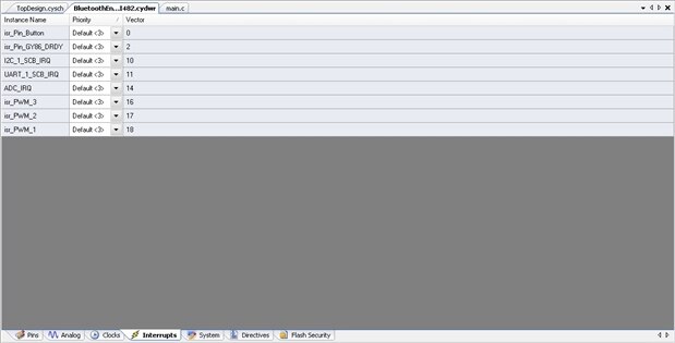

Last but not least for today I want to show the all used interrupts in the PSoC4 as it show the below figure 14.
Figure 14. All Interrupts which available in this project

Before I will move to the source code description I want to complete with settings for the PSoC4 as it show the figure 8 but also the main system clocks as well.
Starting from the main system clocks I have setup it as it show the below figure:
For Analog Circuit for FSR sensor I have below components:
The Pin_FSR_PowerSupply is used as a power supply for FSR and was set as: Digital Output with Strong Drive and fast Slew Rate etc
The Pin_FSR is Analog input and was set as: Analog in Type tab and High Impedance Analog in  General
The Opamp was set as:

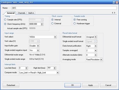

The ADC was set to 11-bit resolution as:
For Button Interface I used:
The isr_Pin_Button was set as Derived:
The Pin_Button was set as: Digital Input, Resistive Pull Up and Initial state High, in input tab the Interrupt was set to Falling Edge.

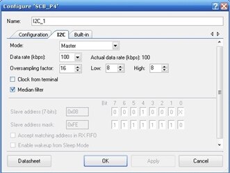

For Interface for GY-86 PCB with 3-axis Accelerometer +  3-axis Gyroscope + 3-axis Magnetometer + Barometer/Altimeter + Temperature sensors
The I2C_1 was set as it show below figure, if higher Date rate will need then 100Kbps can be changed to 400Kbps very easy:
The Pin_GY86_DRDY was set as: Digital Input, Resistive Pull Down with Low value and Rising Edge in interrupt option
The isr_Pin_GY86_DRDY was set as: Derived
The Pin_GY86_INTA was set as: Digital Input, High Impedance Digital, Low initial state, Interrupt None
For BX10 Bluetooth module interface I used:

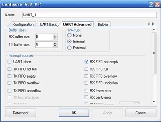

The UART_1 was set as:
The Pin_BX10_PIOx were set as: Digital Input, Strong Drive with low state and Fast Slew rate.
For RGB LED Interface I used:
The PWM_x were set as, but obviously the Compare value is changing programmable for high and low intensity from 5000 to 10000 value.
The isr_PWM_x was set as: Derived
The Pin_LED_x was set as: Digital Output with HW Connection and Output Enable, Strong Drive initial state High and Fast Slew rate.
The Pin_RGB_Control was set as: Bidirectional, Strong Drive with High initial state and Fast Slew rate.

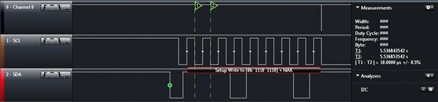

Last week I complete the library for GY-86 and test all the hardware apart from GY-86 which left for the last hardware block.
The sensors library integrate also sensors fusion algorithm for different error compensation and also use quaternions which not suffer from "Gimbal lock" because use 4 dimension orientation instead of 3.
The PSoC4 also calculate the Pitch,Roll and Yaw and offload the external device such as mobile phone to do all sort of calculation which 32bit Cortex-M0 easy able to do it.
Everything seems to be fine, but when I start working with received GY-86 PCB from ebay I was unlucky to manage to communicate with MS5611.
I attached the snapshot from logic analyzer and as you can see I am not getting ACK from the device.
I tried many different senarios such as power up it from separate LDO regulator, trigger SCL line multiple times for unlock the possible freeze on SDA and some other tricks but the IC MS5611 is not respond.
I decide to change 2K2 resistor to 4K7 and also unsolder the dual MOSFET and bridge properly the SCL and SDA but again no any light.
Just thinking to unsolder the MS5611 from the board to see if I can at least to communicate with MPU6050 which this also do not reply. The only IC which seems to work on the board is HMC5883 which gives the DDRY output.
So here in figure 15 is the problem with ACK which I am not getting it.
Figure 15. MS5611 no ACK.
If I will have a luck and the GY-86 will work without the MS5611 sensor then I will upload the project and photos with video.

I also updated the I2C bus rate from standard of 100kbps to 400kbps which optimized for the performance.

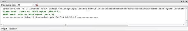

The source code was used all 100% from the MCU Flash memory as you can see from the below image 16.
Figure 16. The PSoC4 32KB Flash was used 100% )))

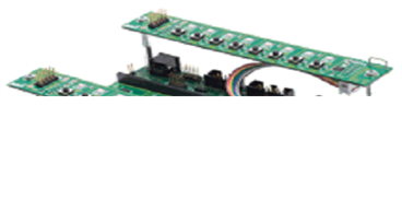

Here we go. This is a prototype image on figure 17 of my project.
Figure 17. Prototype of the Bluetooth-Enabled Smart Shoe.
This is the demonstration of Bluetooth connectivity with PC through RFCOMM link where you can see how ASCII and HEX mode are works with transmission of all sensors data and calculated values for quaternions, Pitch, Roll and Yaw and Euler Angles as well. Plus this FSR value which is reading through SAR ADC, which changing from 0 value to higher numbers when I pressing the sensor area.
The below second video present the operation of Bluetooth-Enabled Smart Shoe with an Android mobile phone and the freeware app "S2 Terminal for Bluetooth Free" which can be downloaded from here https://play.google.com/store/apps/details?id=jp.side2.apps.btterm&hl=en
The below video present the C# PC GUI interface which receive all HEX data by Bluetooth module which send the prototype board and display them on the according boxes and graphical axis.

    Hi Stas, sorry for the situation. It makes one wonder if this is simply a QC issue or a deliberate fraud with counterfeit parts. In the US, we are experiencing severe levels of counterfeits from industry to military, even from previously reputable buyers. This too may have undermined the efforts of the producer of your kit as well.
    I have a project that sees a potential 36+ million units in sales (x $375 each wholesale), and quite frankly the counterfeit issue is horrifying. From the circuit board to the four processors, to the RAM, WiFi IO, IMU, and numerous other components of which any could cause failure of the entire system.
    QC of up to 36M units is expensive, but failure of the product would be devastating. I have to figure how to test each component before committing them to the board, or testing the first batch of boards with each new group of components, which is probably the least expensive route. Global sourcing is a benefit in one hand, and a menace in the other.
    Have you contacted the product manufacturer? It would seem that they would be significantly concerned. If they aren't then it was probably a scam.
    I wish you the greatest success,
    Bryan
    P.S.  Have you considered including load cells in the ball and heel to evaluate the runner's stride quality? Include a data logger so they can download and process.

    Do you know what was the problem.
    You will not believe that. The stencil markers of SCL and SDA on GY-86 was flip. I need to kill that person who type that there )))
    So all good. Solder back the MS5611 and everything is seems to work now.

    DAB over 12 years ago in reply to e14 Contributor
    I wonder if you got a counterfeit part or if it came from the manufacturer mislabeled?
    I would contact the manufacturer to see if they are aware of the issue.
    e14 Contributor over 12 years ago in reply to DAB
    Hi DAB,
    No the GY-86 turn to work properly but the SCL and SDA are wrongly typed.
    I was think the same as you, but after the soldering the MS5611 and playing with MPU6050 just decide to try to flip SCL and SDA pins and was surprisingly shocked by viewing that is working )))
    Ufff, I pass from the hell to come to the paradise )))
