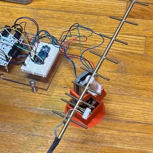

The basic SATNOGS ground station consists of a client system, a radio, and antenna. Some antennas are omnidirectional and are stationary, while others are directional and require a rotor system with elevation and azimuth control.
The purpose of this project is to construct a mini antenna rotator that will interface with the satellite tracking software and automatically point a directional antenna at a chosen satellite to record an observation for upload into the international database.
The SATNOGS client is a raspberry pi 4 with a RTL-SDR radio.
The antenna rotor system is an Arduino micro attached to the TCM5272 Trinamic motor control board, along with two NEMA 17 stepper motors and some custom 3d printed parts.

Using the TMC5272_TMC_API simple rotation C code example as a starting base, here's a video of what a 2.4GHz antenna automatically tracking a satellite would look like:
The code snippet for this demo is below:
To interface the AD Trinamic TMC5272 motor controller to the SATNOGS client, the commands to control the antenna rotator based on the satellite orbit in relation to the observer ground station need to be converted to the motor control commands to move each motor in the elevation and azimuth directions. The list of supported antenna rotators does not currently support the AD Trinamic board, so some sort of conversion must be realized in the Arduino firmware.

The SATNOGS rotor controller incorporates two end-stop limit switches and optical motor position encoders for each axis. I will need to address this in my design.
Another method for this project is to use the SATNOGS antenna rotor controller firmware (RS485) as a base and incorporate the AD Trinamic SPI commands for the TMC5272 motor controller kit.

So I have two problems right now:
1) SatPC32 will connect to the Arduino and send commands through a FTDI serial interface
and the software recognizes the input, but SatPC32 does not format the rotor control commands
in EasyComm format, so I have to figure out what format the commercial rotors use and code that into a library to use.
2) Gpredict outputs the correct format for EasyComm, but I haven't been able to get the rotctl batch file to run correctly for Gpredict to find the module.
This works manually using SatPC32:
Here's a short video
Finally! It works. Here's a video of Gpredict antenna module control of the rotor system with hamlib rotctld running in the background.
I don't have my limit switches wired in yet, however, all the rest of the system seems to be working using Gpredict and HamLib rotctld.
