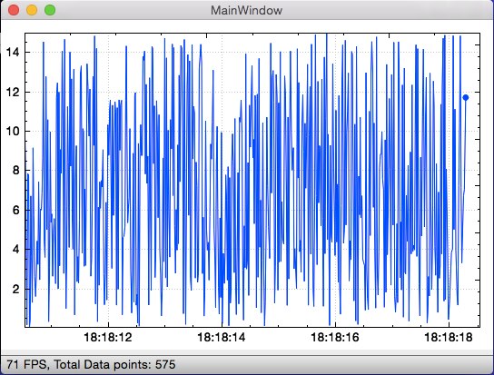

4. Test MQTT client (subscriber)
Test client was written in C++ using Qt framework and QCustomPlot (Qt Plotting Widget QCustomPlot - Introduction charting library + Paho C MQTT library (https://eclipse.org/paho/clients/c/).
I built the test application for Mac and it seems to work fine. Stability still needs to be tested over a longer time interval.
This application subscribes to a hardcoded MQTT topic name and plots the received data in real time:
Figure 1. Test application screenshot
Testing monitor application
5. Performance assessment
This test showed the following:
I was able to display~80(~70) samples per second. CPU usage for mosquitto was around 16% for single publisher and single subscriber but adding more publishers increased the CPU usage - for three publishers and a single subscriber I got a little less than 40%. I think that this is fine while I test the system but to be able to support a larger number of remote sensor units I would have to switch to something more powerful than original RaspberryPi model B (something like Gizmo or even a regular PC).

    DAB over 11 years ago +1
    Nice update, 70 samples per second should be reasonable for your testing. Short of solid data from impacts, it should be a good place to start. Have you contacted any of the safety organizations to see…
  • tomaja
    tomaja over 11 years ago in reply to DAB
    Thanks, no but that's a good idea. I will try to find some information.
    Anyway, I rechecked my sample rate estimate, it's ~80 samples per second (1200 samples in 15s) but I think that my Bash script is to blame. It will probably be faster when I start sending real data.
