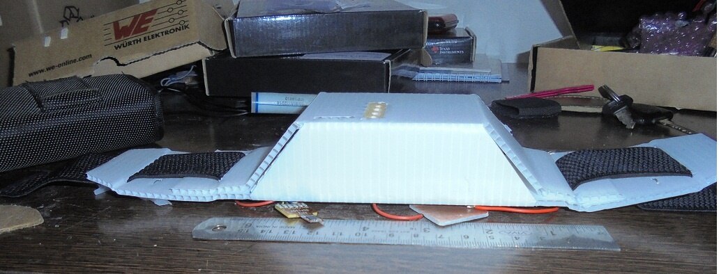

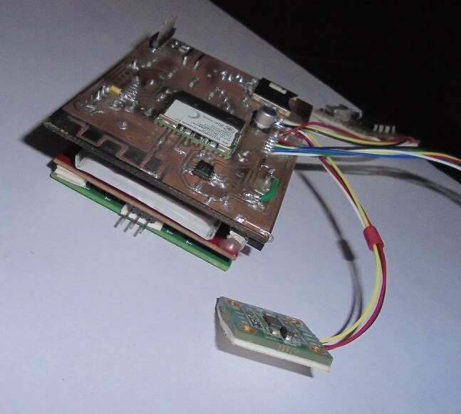

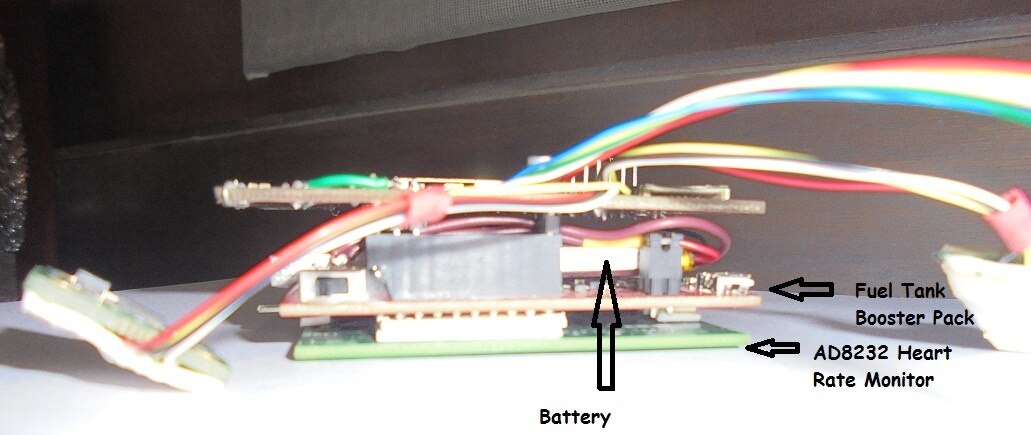

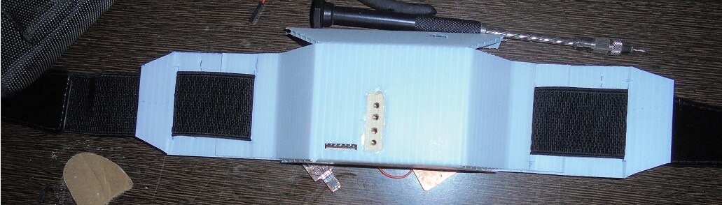

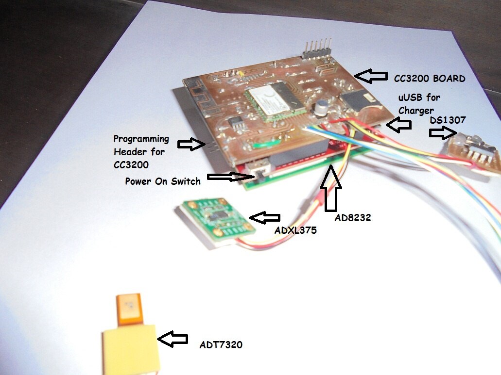

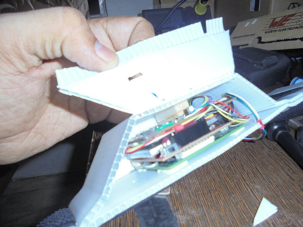

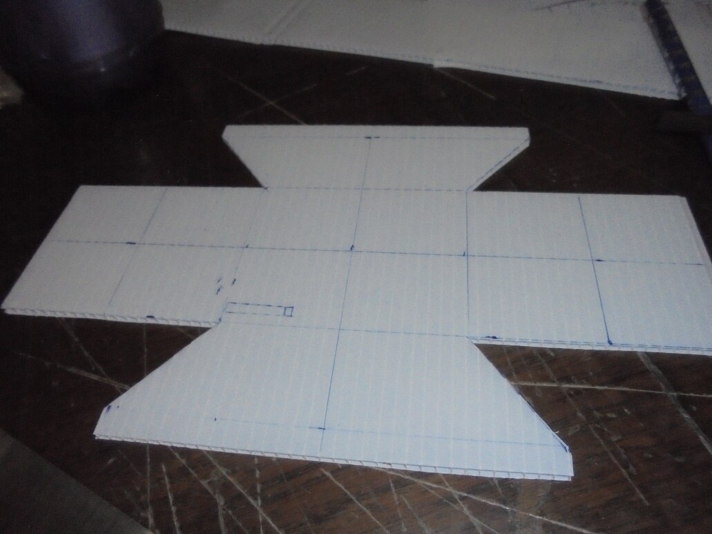

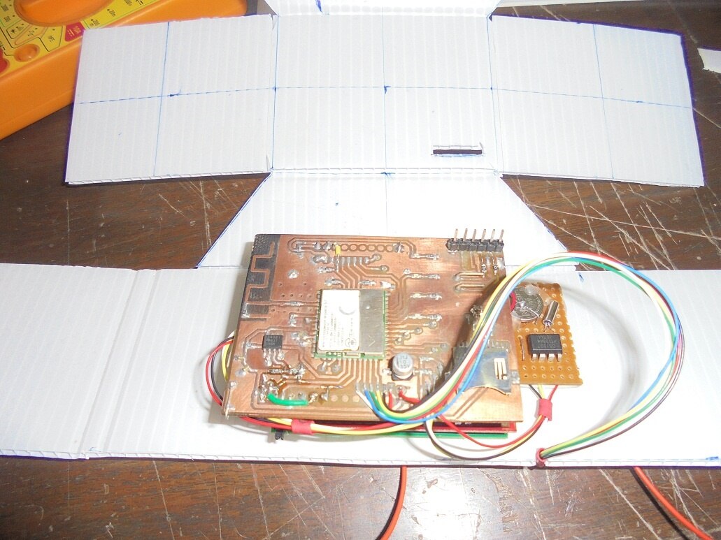

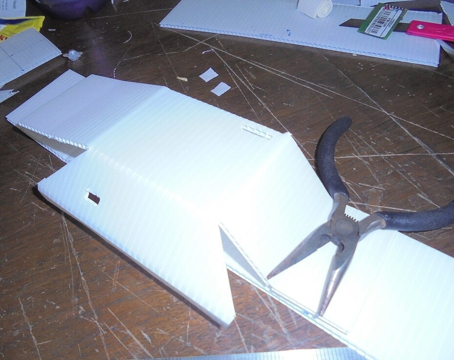

Here is demo video of CC3200-mod based Chest Strap and Halmet mounted wireless impact sensor in action with android App..
This video shows demo of CC3200 -mod based chest strap module working with Android App...

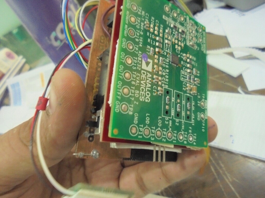

I havn't wear this module so even I have interfaced AD8232 Heart Rate monitor, I am sending junk data to app for heart rate..
Temp sensor ADT7320 is interfaced and data are perfect..
ADXL375 Accelerometer is on CC3200-mod module to detect chest impact, It is not caliberated so it shows acceleration more than real acceleration..
Halmet Acceleration Sensor is working just fine... It is MSP430+ADXL375
Shortly I will share fully working module with application with some Graph future to observe ECG signal also....

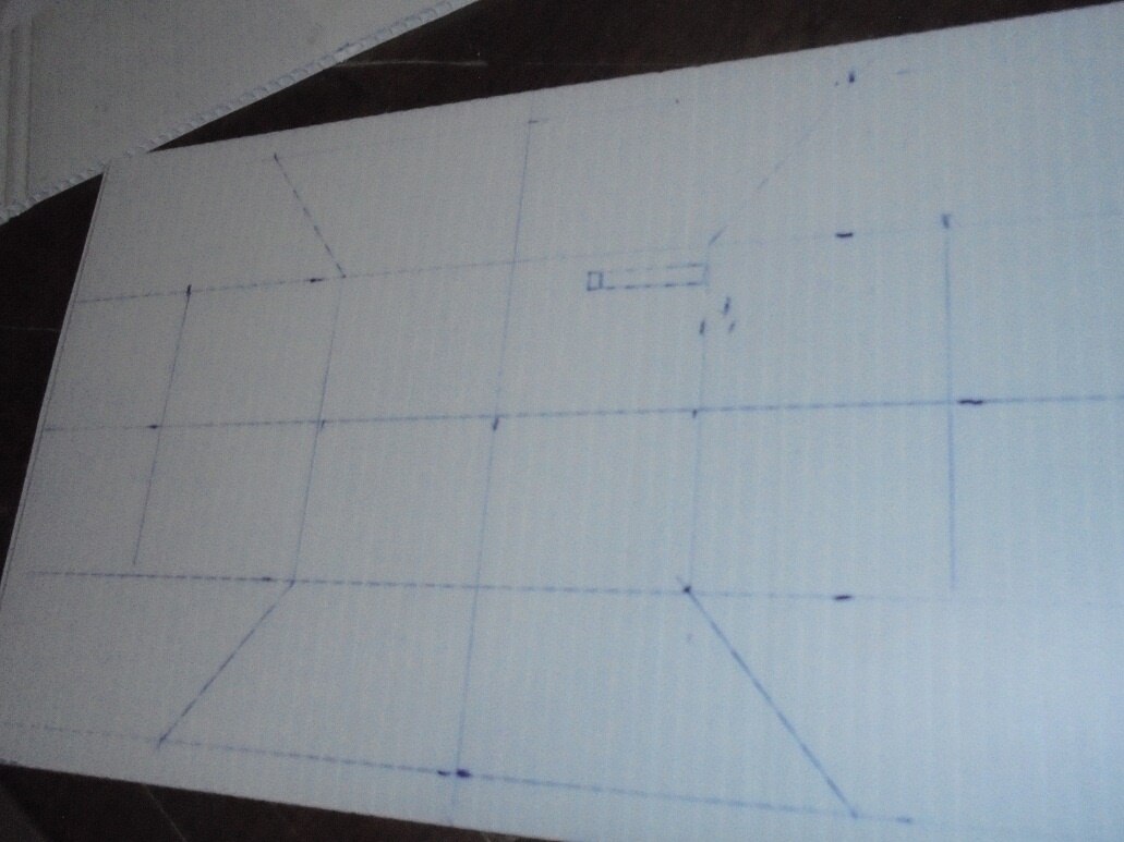

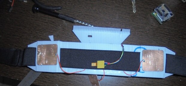

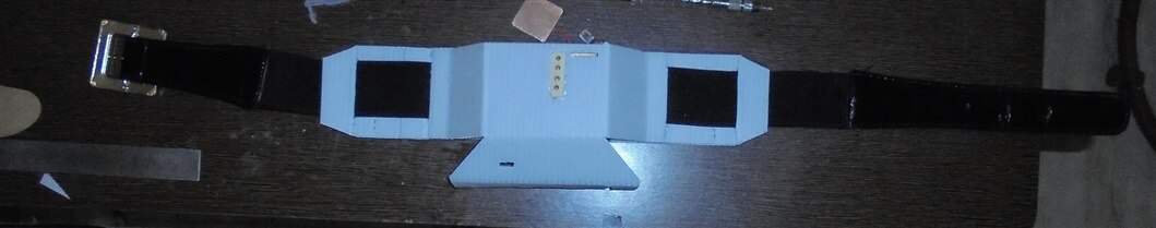

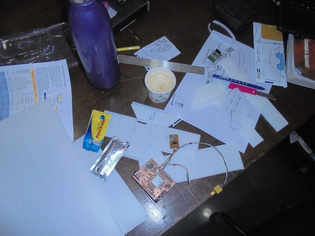

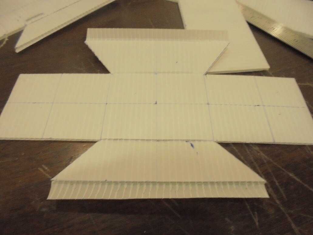

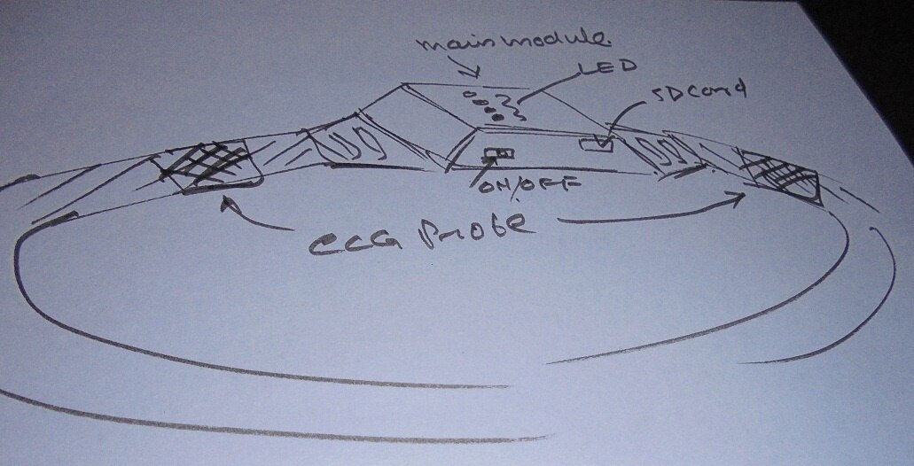

Here Is small photo story of assembling Chest Strap ....
Very soon I will publish all my code, Apps and Test Video here...
Thanks
Ravi

    and even all the passive components and LEDs are 0603 package... you will find large spacing between components only because i have only hand soldering option and it need large work area around components.. as the same is not necessary when there is machine/reflow for all components... So there was lots of planning before layout preparation.. Today I am confident that If have have given chance to commercially fabricate the PCB and component soldering will be done in professional reflow oven, I can reduce the size of PCB by atleast by 1/4 of what it is right now...
  • ravi_butani
    ravi_butani over 11 years ago in reply to balearicdynamics
    I have used simply toner transfer method with FeCl3 as enchant for build PCB.. As all the PCBs are two layer..it was a trivial task to limit no of vias while preparing layout...even after that it was very hard work to short these vias by hand soldering... But any way I have done it satisfactory with out wasting any PCB...
    balearicdynamics over 11 years ago
    Nice. Good choice for the boxing material. How did you build the PCB ? I am curious image
