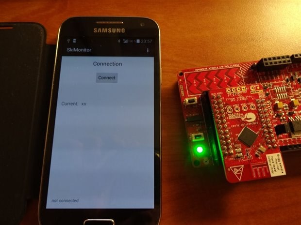

When no connections made, the BLE kit happily blinks its LED:
(and I probably should have some other default string for the current acceleration value...)

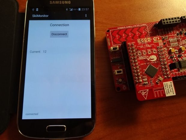

When the connection is established, the LED goes off, and the App now shows the current acceleration value (which is actually the average acceleration of the last second):
12g are actually a little bit high, but fortunately its just fake data image
