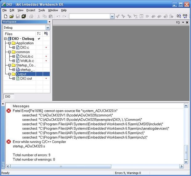

Next I downloaded the software for the Eval-AduCM350EBZ, but for this board things did not go so smoothly.   Here is a picture of the Eval-AduCM350EBZ connected to my computer.
After downloading and installing the drivers, which did not give me any trouble, I installed the software and I tried to use the instructions in the getting started document to compile and run an example project.  Here is a screenshot of the steps I wanted to follow.
But when I reached step 3 I got an error:
So it looks like the issue is caused by a missing file.  I then searched my computer and found the system_ADUCM320.h file in the Keil directory.
Reading through all the software and instructions in that getting started document I’ve got to a point where everything looked kind of “cloudy” and hard to make sense of.  Following another list of steps in that document I was able to open that DIO example project in micro-Vision:
Here I was able to “build” the project but when I tried to load it in into the AduCM320 microcontroller I’ve got a timeout error.  So far I did not figure out why I get this error.
