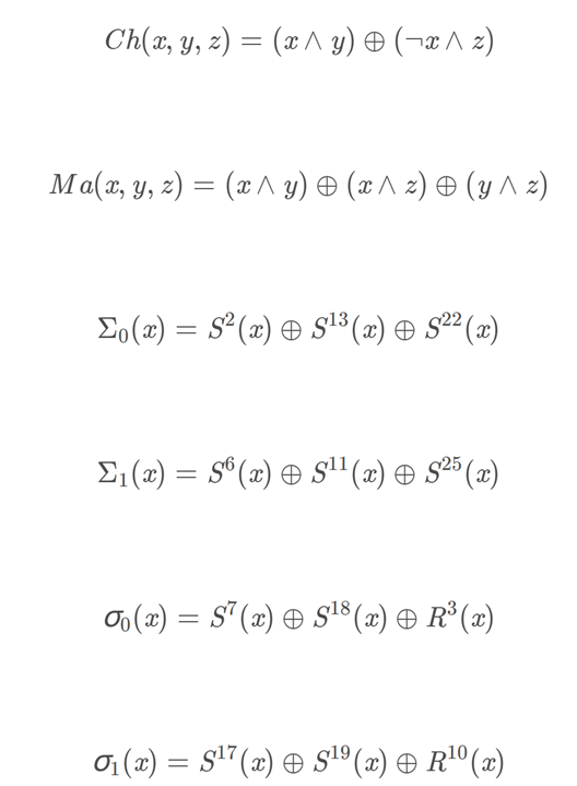

2.3 Define basic function
There are combination calculation with six key functions,
Transfer the initiate value into final hash value.
M(i) stands for raw data blocks input in series. What ever the size and value the input, final output is always 256 bits.
