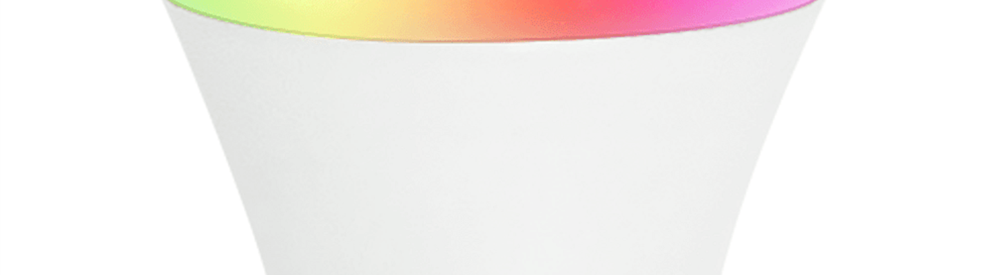

Selection of the Smartbulb
There are dozens of manufacturers of smart home accessories and almost all of them have a product range of smart bulbs available. As mentioned in an earlier blog I decided to go down the WiFi route as it suited my design needs and target audience the best. Browsing through Amazon you will see there are many really cheap, unbranded smart bulbs. Although these work perfectly well in general, I made the decision to go with a bigger brand as they would have better support, a wider product range and will probably be around for much longer.
I remembered reading an article a while back about TP-Link’s range of smart devices and it seemed to indicate that controlling the smart bulb was relatively straightforward using a defined set of JSON commands over a TCP connection. Since a lot of the other manufacturers seemed to have inaccessible or proprietary APIs, TP-Link seemed like a decent way to go and they also seemed to have a nice range of smart bulbs, plugs, switches and cameras. I particularly like the new range of smart spotlights that they have coming soon!
https://www.tp-link.com/uk/home-networking/smart-bulb/
So having decided to go for a TP-Link smart bulb I immediately want to Amazon and bought the cheapest WiFi, colour, non-hub, smartbulb that TP-Link sold. At this stage I hadn’t realised that they had two product lines (“Kasa” and “Tapo”), so I bought the TapoL530B available here (more on the other product range later).
