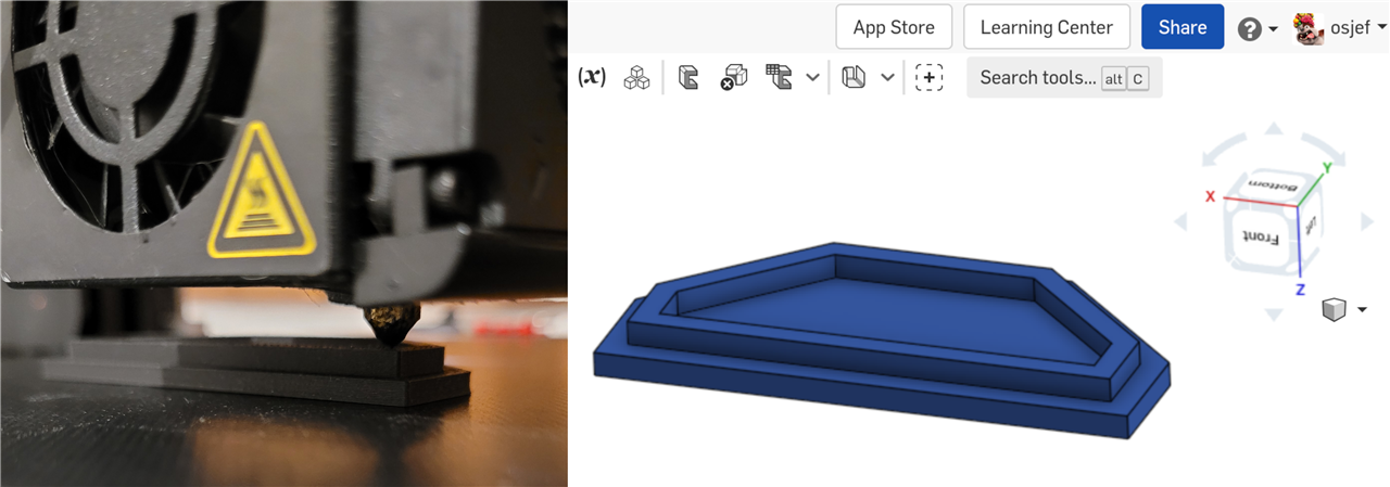

Having designed all the parts of the 3D model and "assembled" them together in the CAD package to make sure that all the sensors would physically fit and operate where I wanted them to go, the next stage was to get the parts 3D printed. Sadly my 3D printer is offline for repair and modification at the moment, but fortunately one of my friends who is into his 3D printing kindly agreed to pop my model into his 3D printer for me - thanks a million!
After exporting the model in STL format from the onshape editor, the model is first put through the 3D printer's slicing software - in this case "Cura". Below you can see a cross-sectional view of the 3D model prior to printing:

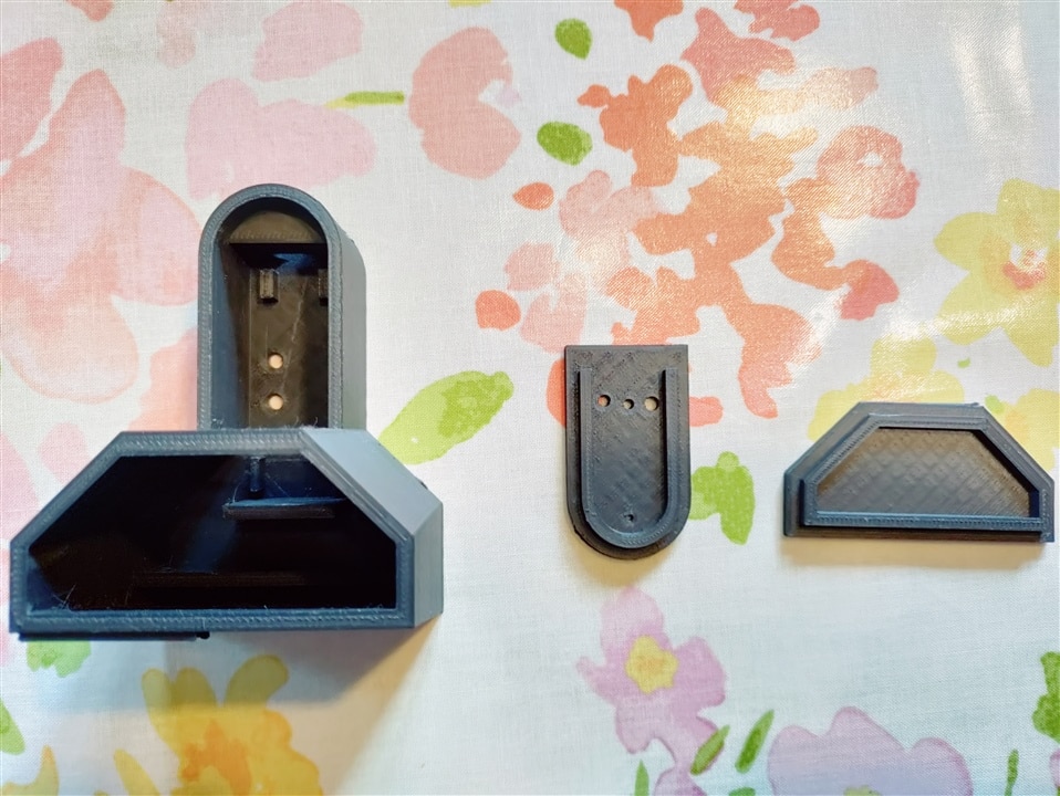

And here are a few pictures of the parts being printed alongside their 3D design:
And here is the final 3D printed box, ready to be removed from the build platform. (Note that the "Vishay" logo is absent from this CAD model as it was added to the model in Cura.)

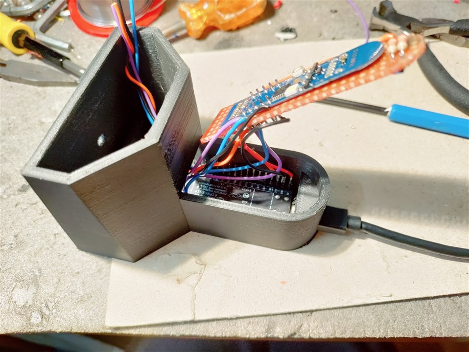

  • Fixing the ESP32 micro-controller board (inverted) into the bottom of the box
  • Soldering the VEML3328 sensor board to the single-sided copper stripboard along with the two I2C pull-up resistors
  • Placing that assembly into the lower section at the back of the box

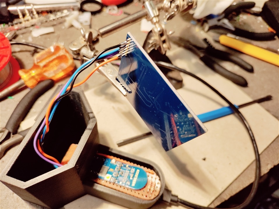

  • Sliding the VCNL4035 sensor board vertically into the front of the box
  • Soldering the last wires in place

The model removed from the build platform

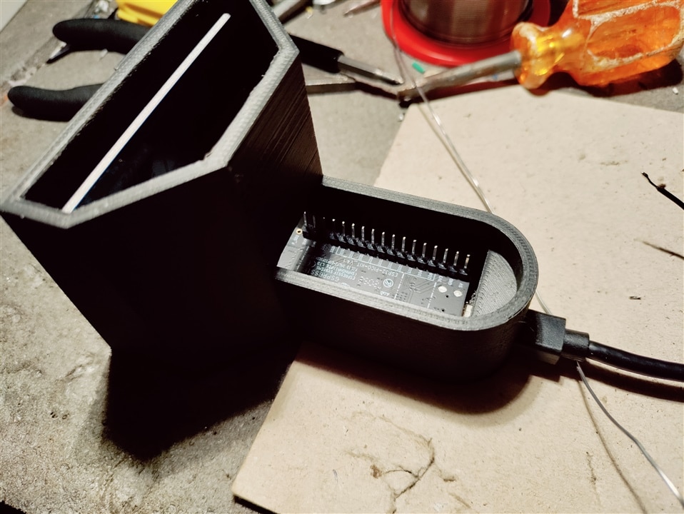

ESP32 micro-controller fitted (inverted to allow access to the reset button through the bottom of the box)

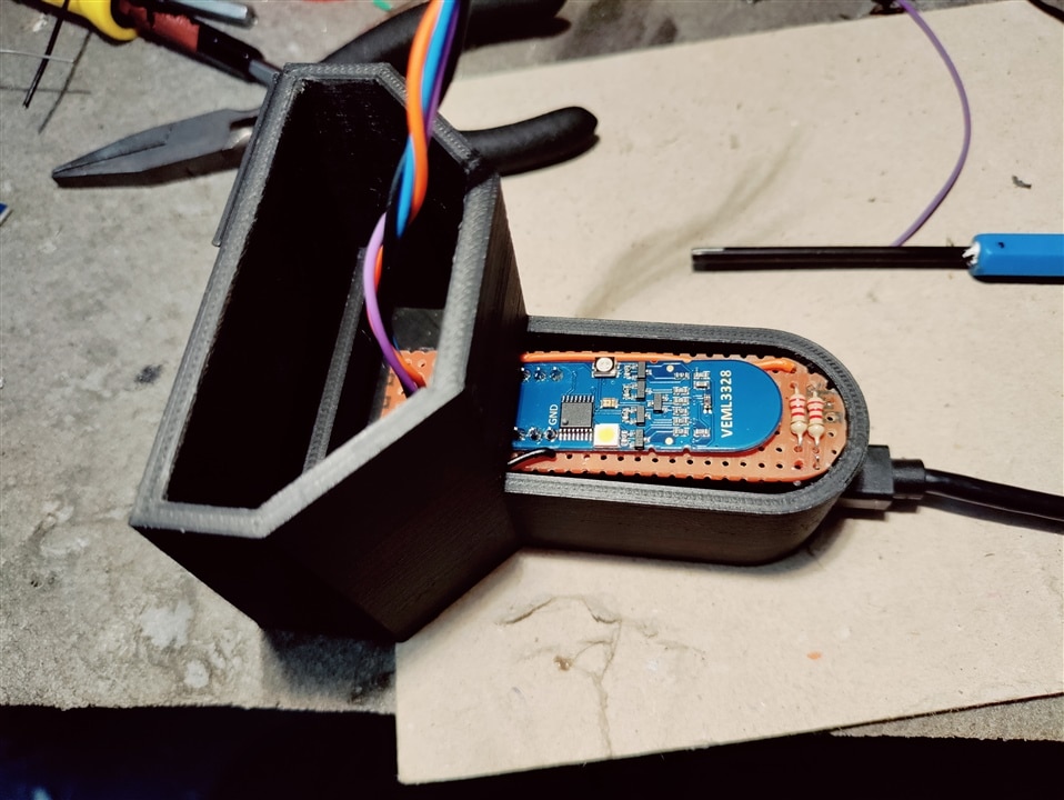

Soldering the VEML3328 sensor board connections
Fitting the VEML3328 sensor board in place (just about enough clearance!)

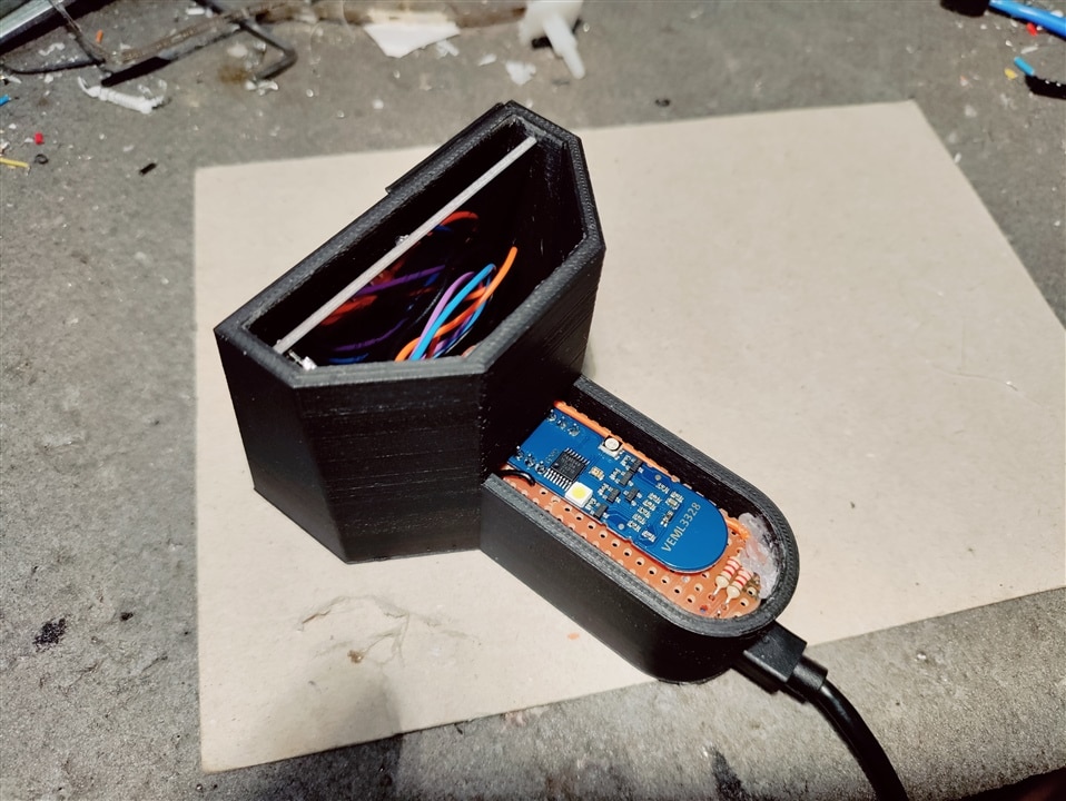

Soldering the VCNL4035 sensor board connections
All sensor boards wired up and fitted - ready for the lids

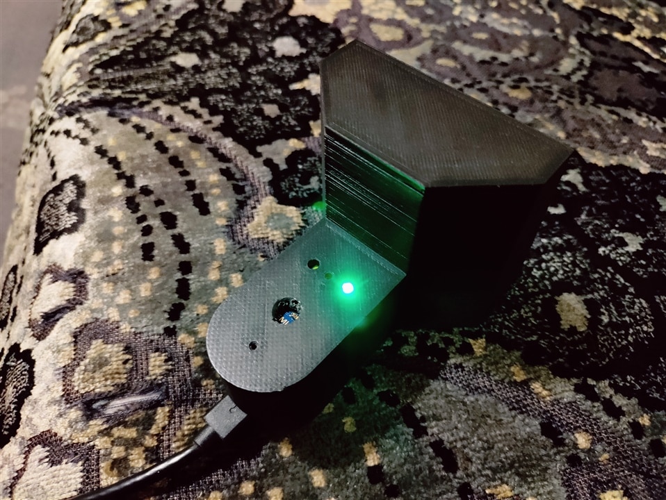

All assembled and USB cable fitted
Powering it Up
And the final step is to turn it on and hope it doesn't let out the magic smoke...
It worked! And the green LED (which aligns with the hole in the lid perfectly) is lit indicating a connection has been made with the smartbulb.
Those of you who are observant will have spotted that an extra hole has appeared in the lower lid Grinning Well, when I was designing the lid I spotted a component on the board between the two LEDs which looked like the VEML3328 colour sensor. However, when I powered everything up with the lids fitted, it wasn't reading the colour of the room correctly (or at all in fact). After digging out the PCB layout for the VEML3328 sensor board I realised that the component in between the two LEDs is actually the IR LED (kind of makes sense now looking back on it - there is the RGB LED, the white LED and the IR LED all three in a row). Looking at the PCB layout I spotted that the VEML3328 colour sensor SMD component is actually at the tip of the board (the rounded end) - wonderful thing is the datasheet! The position of the sensor is highlighted in the PCB layout below:
So I manually drilled a hole into the lower lid, re-assembled and it magically sprung into life.
