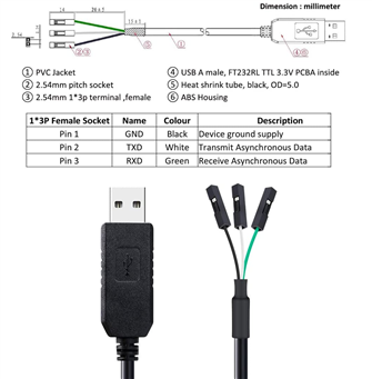

3. UART communication between a XMC4200 microcontroller and computer
    To control the microcontroller and sensors later, I would like to have a debug UART console. Inside DAVE, we can enable UART and I have a USB-to-UART cable which can be connected to P2.14 an P2.15 pins. So, I connected the USB-to-UART cable with three wires like the picture below. This cable came with a FTDI FT232RL chip.
4. Develop a small application involving UART and LED
The small application starts with initializing the UART communication between a PC and XMC4200 microcontroller. Then, depending on the user input (ex: 0, 1, or 2) , XMC4200 takes action on the LED.
