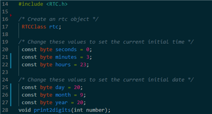

By making good use of Infineon example codes of RTC, I used RTC.h header file and RTCClass for XMC4700 relax kit.
The one thing to keep in mind is we need to set the current initial data. Here is how the RTC codes are implemented.
Initializations

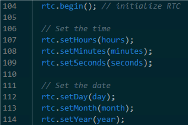

setup() funciton

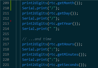

loop() function

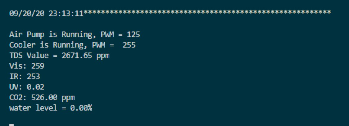

Using virtual UART console, we print out logs of data with timestamp from RTC codes. Here is an example.
The first line is the printout of the RTC timestamp.
