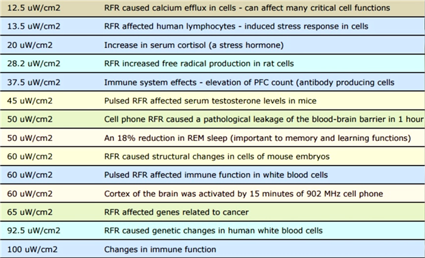

As mentioned, I have collected a pile of information and studies on the hazards of low level EM radiation and much of it is worrisome if not downright scary, but although many symptoms have been linked to EM radiation, the risks do not appear to be high enough and the symptoms do not appear to be severe enough (with proven causality) to warrant immediate regulatory intervention. However, just because the light is green doesn't mean there is no risk to crossing the street. Sometimes it is worth looking both ways before crossing anyway.
I won't re-print all the data but here is an example table of some potential symptoms and effects from low-level EM radiation:
Notes:
  • RFR is Radio Frequency Radiation
  • To convert mW/cm2 to mW/m2 multiply by 10

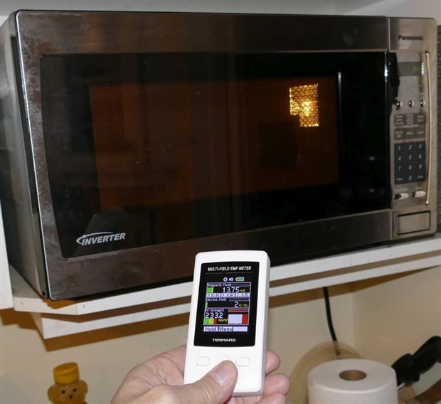

This image show readings from a decent microwave oven (I've seen worse). The readings drop from 232 mW/m2 at 1 foot to 1 mW/m2 at 6 feet.
Safety Tips: It is easy to stay at least 6 feet from running microwave ovens.

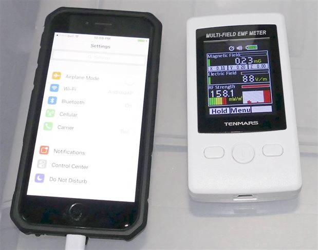

This image shows readings from a cell phone coming out of airplane mode and reconnecting to a cell tower to get email.
Safety Tips:
  • keep the phone in airplane mode whenever it is not in use or expecting an urgent call
  • when exiting airplane mode, keep the phone a few feet away
  • when making a call, use a headset rather than putting the phone to your ear
  • if you don't have a headset, use speaker phone mode
  • try to make calls where reception is good – the phone will throttle back on transmit power
  • use text instead of voice – it keeps the phone further from your body and can reduce transmit time
  • use a land line when possible
  • when driving, use a hands free system and put the phone away from your body
  • put the phone in airplane mode at night while it is charging or keep it a reasonable distance from your body

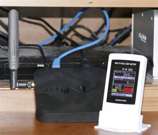

This image shows readings from a Wi-Fi hotspot measured from 6 inches away.

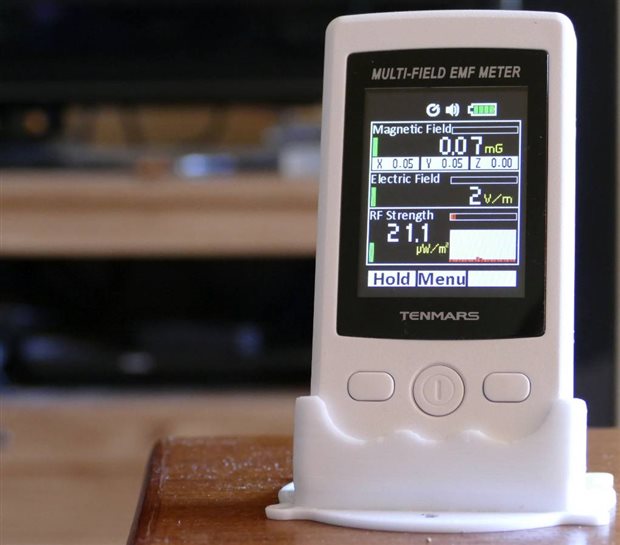

This image shows readings from a Wi-Fi hotspot measured from 54 inches away.
Safety Tips:
  • Turn the Wi-Fi router off when it is not needed (when you are sleeping for example)
  • locate the Wi-Fi router away from commonly occupied spaces, but close enough that client devices do not need to crank up to full power to access the router

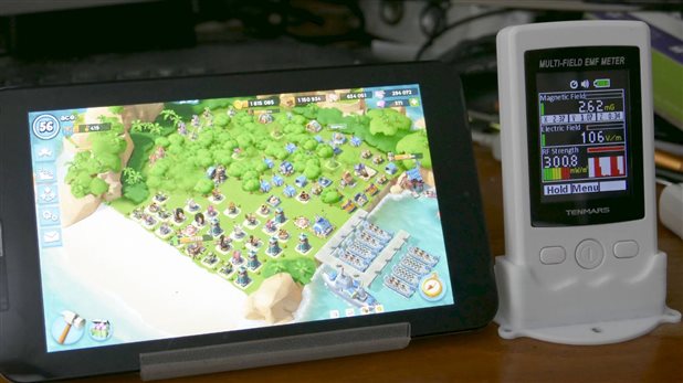

This image shows a tablet using Wi-Fi to update its game.
Safety Tips:
  • use a big tablet at full arms length from your body – on a table not your lap
  • operate it close enough to your router to get all signal strength bars lit
  • use a wired Ethernet connection if possible

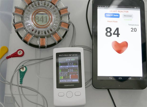

This image shows a couple of Buetooth devices communicating.
Safety Tips:
  • move to Bluetooth low energy (BLE)
  • keep devices at arms length when possible
  • Bluetooth headsets are better than putting a phone to your ear, but not as good as a wired headset
