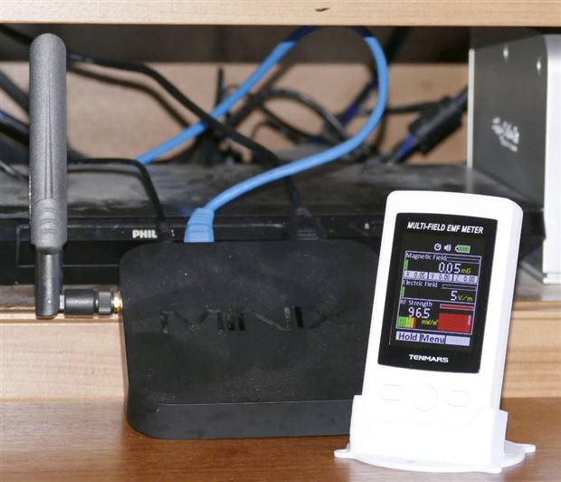

This image shows readings from a Wi-Fi hotspot measured from 6 inches away.

Safety Tips:
  • Turn the Wi-Fi router off when it is not needed (when you are sleeping for example)
  • locate the Wi-Fi router away from commonly occupied spaces, but close enough that client devices do not need to crank up to full power to access the router
