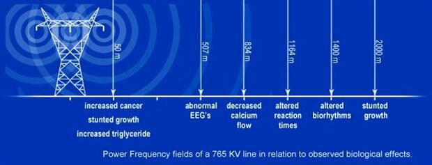

There have been many studies to try and answer this question. Some statistical studies find adverse effects such as these:
While other studies find no conclusive causal evidence. For example the most definitive statistical studies indicate the incidence of leukemia in children living within 600 m of high voltage lines is double that of children living further away. But there is no known causal mechanism that explains how these fields might cause leukemia. Maybe the high fields alter something else in the environment that promotes leukemia. It would seem that real adverse effects from power lines are at most a low probability – even in the leukemia studies, of the 1 in 5,000 children that contract leukemia, less than 1% of these would be living near power lines. This is over 500 times rarer than the incidence of prostate cancer in men.

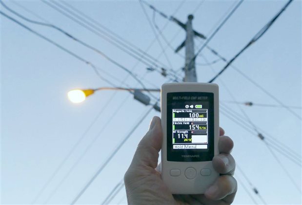

Here are the fields a couple of streets away where the power is on telephone poles.

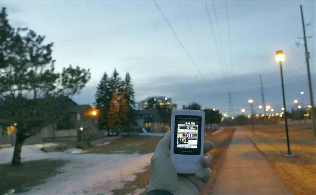

Here are the fields a few blocks away under power lines.
2000 volts per meter and I couldn't feel a thing.
The meter was in its red zone and beeping away to indicate high fields.
These power lines run pretty close to houses.
I don't know how safe or dangerous it is under these power lines, but the fields are up to1000 times greater than at my house - so lets go inside.

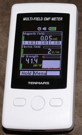

This is a normal baseline reading in my house, although the RF strength can be less if WiFi is not active.

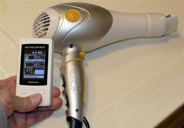

Lets compare these readings to some household appliances:
Electric Razor
computer and LCD

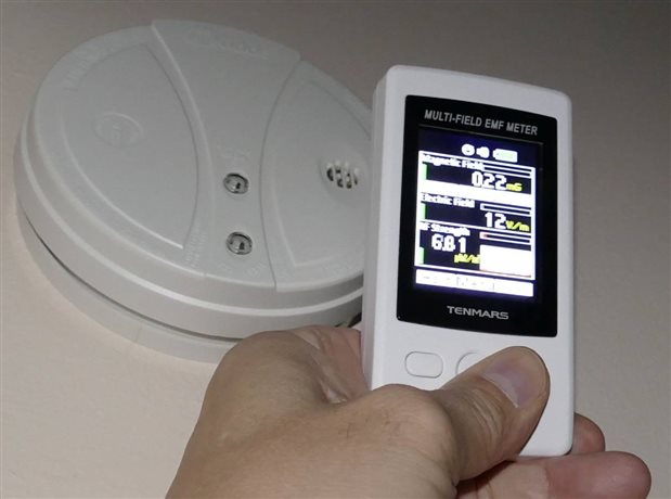

Fire Alarm
Hair Dryer

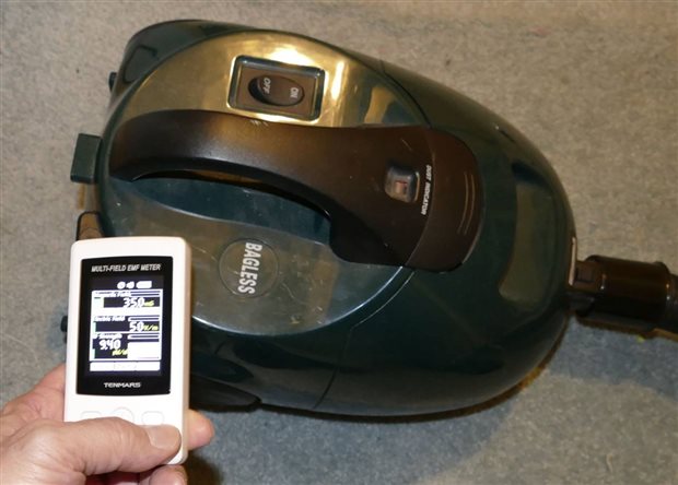

Vacuum Cleaner

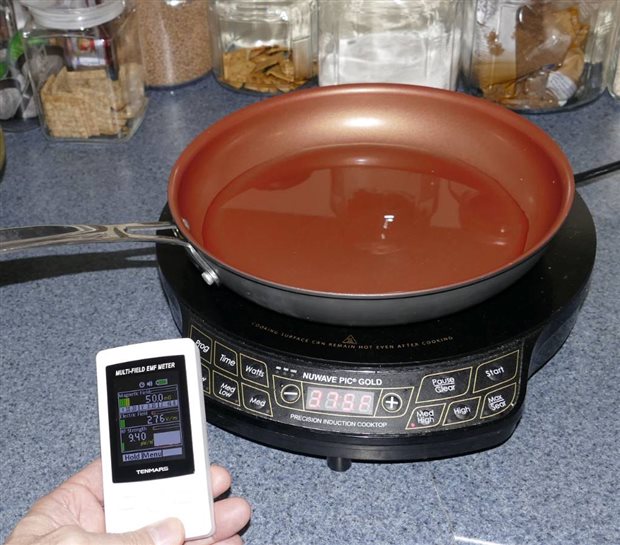

Induction Range

My meter has green, yellow and red bar graphs to indicate when the manufacturer thinks the fields are safe, not safe for long exposure and unsafe for even short exposure. Most household appliances are green in the ELF bands and many of them are only on for short periods. This does not mean they are all safe – for example electric razors and vacuum cleaners can and will damage your hearing if you don't take precautions, but this blog is about things you cannot sense yourself.
