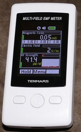

This is a normal baseline reading in my house, although the RF strength can be less if WiFi is not active.

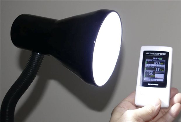

Lets compare these readings to some household appliances:

LED Lamp
