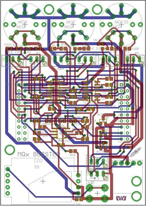

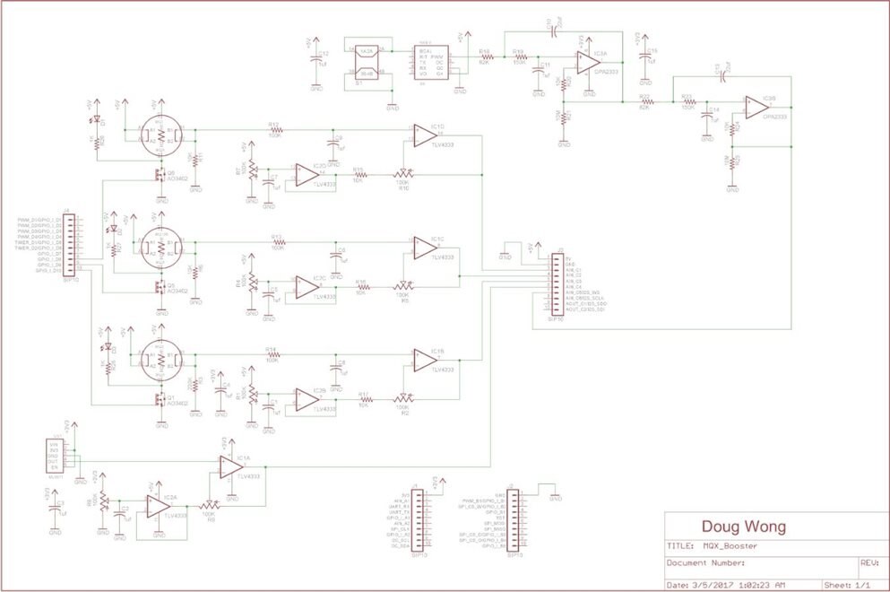

This blog details the circuitry and PCB layout of my custom Booster Pack to monitor 8 hazardous gasses and ultraviolet light. I added some active circuitry to filter the CO2 sensor PWM output since my last blog. This is a 4-pole low-pass Butterworth filter with a cut-off frequency of 10 Hz. (The signal is 1 KHz PWM).
The PCB is laid out to fit on the   https://www.element14.com/community/view-product.jspa?fsku=2473128&nsku=41Y9541&COM=noscriptMSP-EXP432P401R MCU as a normal Booster Pack The pins it uses are carefully selected to not interfere with pins used by the  430BOOST-SHARP96430BOOST-SHARP96 LCD or the CC31000ModBoost WiFi nodule
The following table shows the Booster Pack pins used by each of the modules in the kit plus my custom Booster Pack. I have highlighted the modules/pins I will be using. Note there are lots of conflicts if you want to use all of these modules together. They can often be resolved with jumpers on the cards, but the process must be thought through in detail. Even with the modules I have selected, there are a couple of conflicts which I need to resolve. I will permanently enable the LCD, so it doesn't need a control pin and display COM inversion pin will be disconnected and not used. In the end, my project will use 34 of the 40 pins - all of J1 and J2 plus most of J3 and J4.
Booster432P401RMCUSHARP LCDCC3100ModBoost BoostXLBoostSense1CC2650BLEDLP7970ABPMQ_booster

Hopefully this table will save some of the other contestants some work, although they will still need to check everything.
The PCB layout is shown below. It is intended to sit above the MCU, but below the LCD. The WiFi module will go below the MCU. The sensors will surround the LCD without increasing the width of the whole stack. This is because I have to mount three other instrument clusters on my arm beside this sensor stack.

    DAB over 9 years ago +3
    Great post Douglas. I am curious about how easy it would be to set up a generic socket for the sensors so that you could change them out for different seasonal needs? Just a thought, DAB
    Jan Cumps over 9 years ago +2
    dougw , when you publish your boosterpack, you could request to have it added to the compatibility checker . It's an interactive version of your table for a combination of LaunchPads and BoosterPacks.…

    dougw over 9 years ago in reply to Jan Cumps
    Thanks for the tip about the compatibility checker - it confirms my data.
    It seems to only compare default configurations, but I haven't explored it much yet, so I can't be sure.
    The LCD module for example a has a lot of configurability based on zero ohm jumpers.
