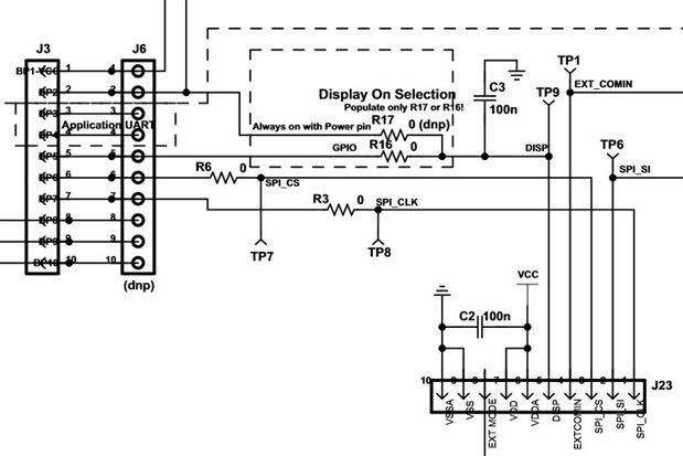

This update covers my first attempt to fire up the  MSP-EXP432P401RMSP-EXP432P401R I am using Energia at this point since they claim to support this platform and the Sharp display.

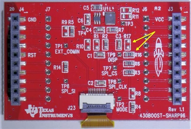

I modified the  430BOOST-SHARP96430BOOST-SHARP96 to be always enabled by unsoldering the R16 zero ohm resistor and soldering it at the R17 location. This is needed in my design to avoid a conflicting use of one of the GPIO pins. (It conflicts with the CC3100 Boosterpack)
Here is the corresponding schematic:

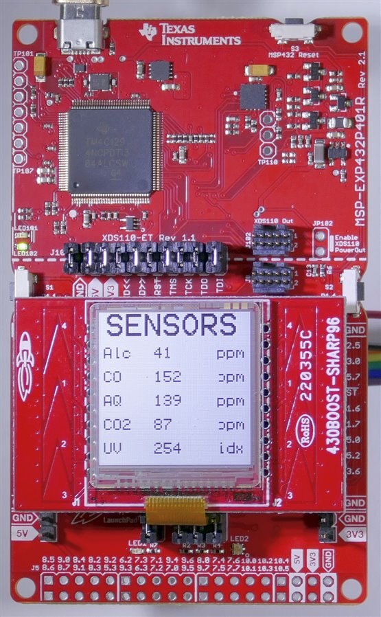

The Sharp Boosterpack LCD plugs directly on the  MSP-EXP432P401RMSP-EXP432P401R as shown below
You can see the results of my first code in the picture.

One thing to note - the Energia selector for the target board did not show the MSP-EXP432P401RMSP-EXP432P401Rin its list it just showed Launchpad /w MSP432 EMT (48MHz)" - but it seems to work.
I do not have my sensor Boosterpack back from the PCB shop yet, so I connected 5 potentiometers to simulate the 5 sensors.
Here is a demo video of the system in action:

    Here is an update... It is ok to laugh... I just completed the change on my 430BOOST-SHARP96 of moving the R16 0 ohm resistor to R17.... But not without issues.... De-soldering went without a hitch, picked…
    mcb1 over 9 years ago in reply to dwinhold +3
    Product Link Product Link Same thing happened when we were fixing my Intel Edison breakout board. The regulator chip went flying .... luckily I ordered two. To help remedy this I brought one of these for…
    dougw over 9 years ago in reply to dwinhold +2
    All I know is when it happens to me, it is the opposite of a laughing matter. The expletives can be significantly more vehement that you would expect from loss of a 1 cent part. A piece of wire can be…

    dougw over 9 years ago in reply to jomoenginer
    Thanks for the tip.
    The sensors will eventually be run in a sequence to ensure their heaters are not all on at the same time.
    imageimageimage All I know is when it happens to me, it is the opposite of a laughing matter. The expletives can be significantly more vehement that you would expect from loss of a 1 cent part. imageimage
    A piece of wire can be substituted for that resistor.
