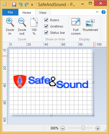

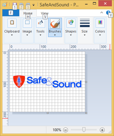

As an example, I downloaded the Element14 Safe & Sound log, and using MS Paint, I made some minor changes and then created a .bmp. file to be used with Image Reformer.

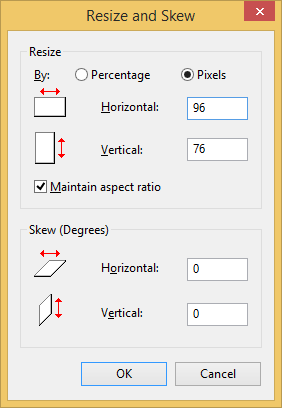

First, open the file in Paint (Or an equivalent tool to create bitmaps with).
Resize the image to fit n the Sharp LCD 96x96 pixel screen:
If needed, you can zoom in or out to work on the image or add Gridlines to edit each pixel. I changed the '&' symbol color to black so it would stand out in the black and white image from Image Reformer.

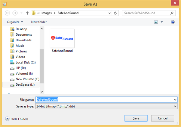

Then, save the image as a 24-bit bitmap with a ".bmp" extension for use with the Image Reformer Tool.

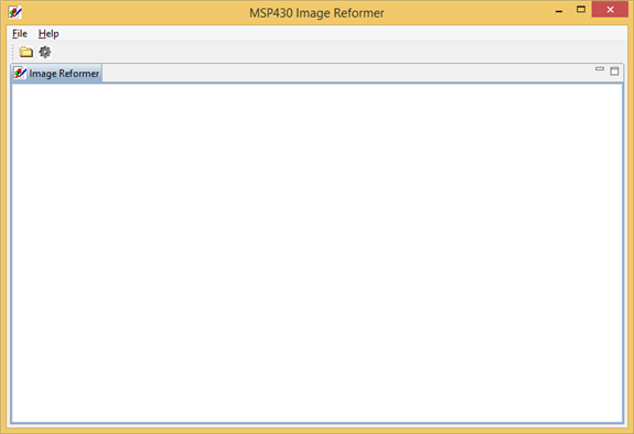

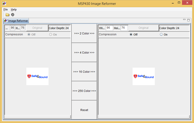

Then launch the MSP430 Graphics Library Image Reformer tool.
On my system, after it was installed, the tool executable was found at:
     C:\ti\msp430\imagereformer_1_00_00_00\imagereformer.exe
Once the Image Reformer Tool is launched, you will get a blank page.

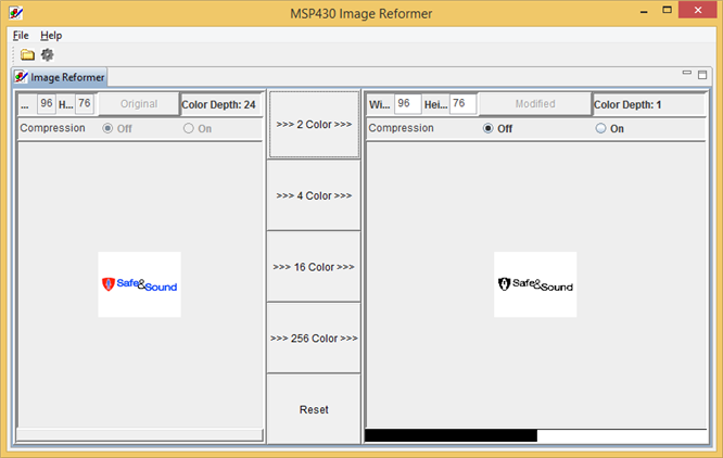

From the 'File-Open Image' menu option, find your bitmap file and open it.
The image should be shown on both the left and the right screens.
From here,you can set the Width, Height, Number of colors to use and whether Compression is on or off.
For the Sharp 96x96 LCD, I found  the following settings to work best:
  • Number of colors - 2 Color
  • Width                   - 96 Max
  • Height                  - 96 Max (76 in this case)
  • Compression       - Off
This will change the image on the right to a Black and White Image.

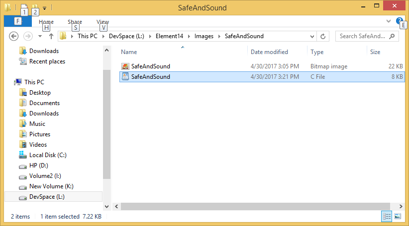

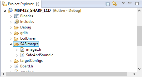

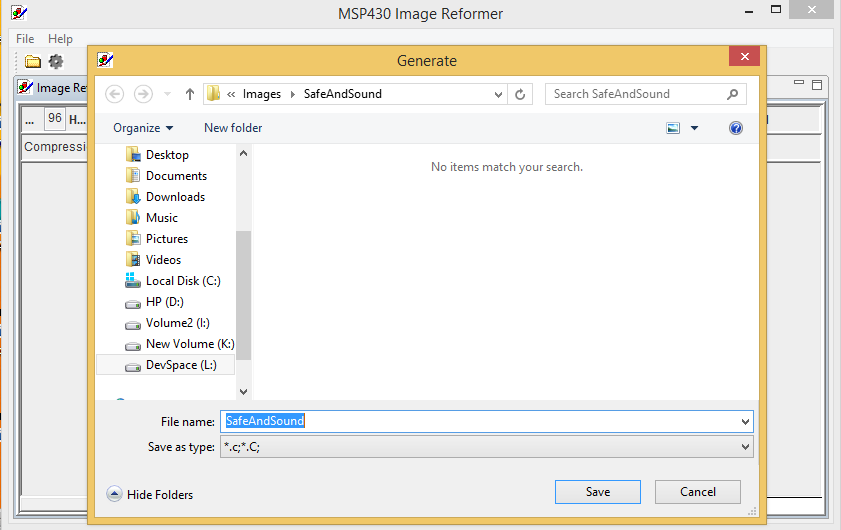

Once the settings are in place, just click on the Gear icon next to the folder icon in the menu bar to Generate the image 'C' code.
This will generate the '.c' file that will be used in the Code Composer Code to display the image on the LCD screen.

This file can be added to a CCS project such as the MSP432 Sharp LCD example that Jan Cumps outlines:
I added a 'images.h' file to add an interface to the image so I can just include this where I wish to use the image code.
For the Safe & Sound image, the '.h' file looks like this.
 * images.h
 *  Created on: Apr 20, 2017
 *      Author: Jon Morss
#ifndef HGSIMAGES_IMAGES_H_
#define HGSIMAGES_IMAGES_H_
extern const Graphics_Image  SafeAndSound1BPP_UNCOMP;
//extern const Graphics_Image  TI_Logo_69x64_1BPP_UNCOMP;
#endif /* HGSIMAGES_IMAGES_H_ */
To use the image, just include the header file for the image where the image will be displayed.

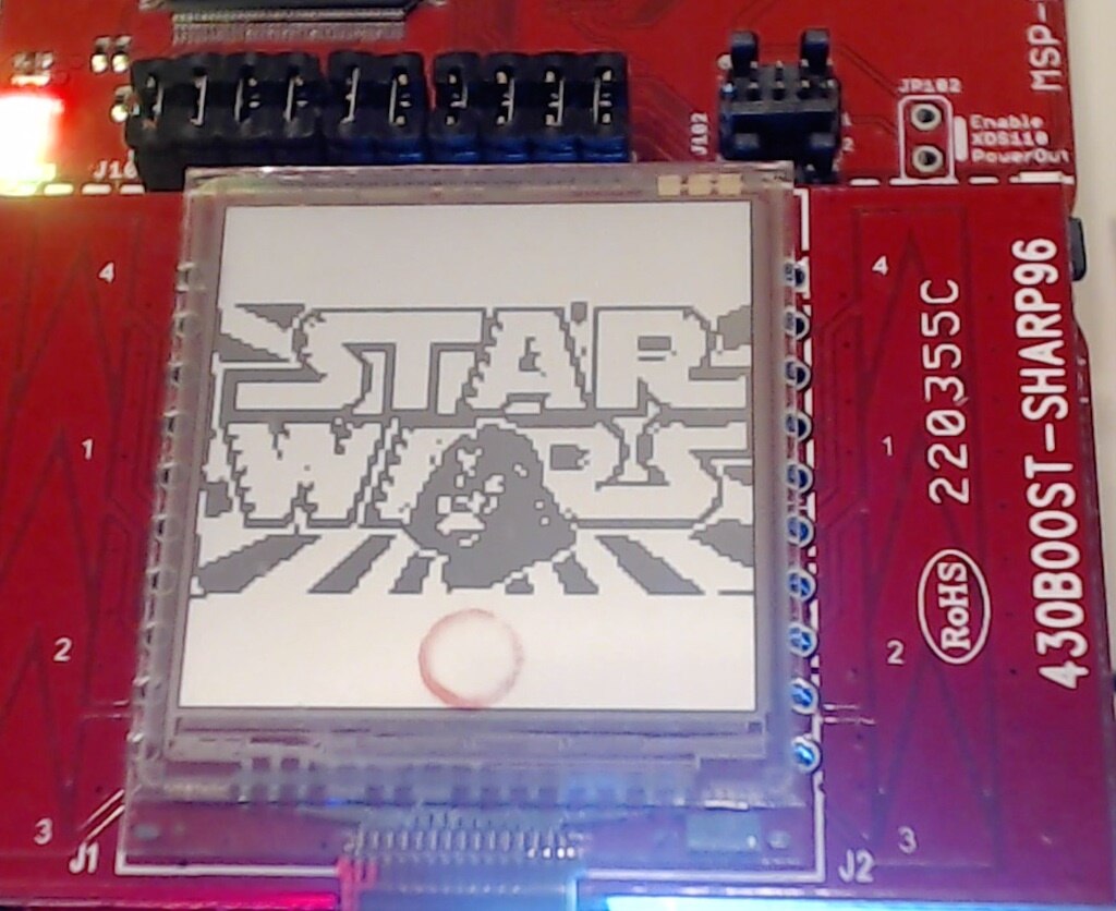

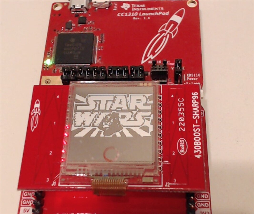

    System_flush();
    drawLogo();
    Delay(10);

As a result, the image should look like what is seen in the following vid.

    Jan, Here is a Compressed RLE4 image that was Generated by Image Reformer and displayed on the Sharp96 LCD with a MSP432.

    Jan, I wonder if the issue is that the CC1310 has a Cortex-M3 vs a Cortex-M4-F as does the MSP432. However, here is the same image running on the CC1310 using the 'display' example from the SimpleLink…
    Jan Cumps over 9 years ago in reply to jomoenginer +2
    I haven't tried uncompressed yet. I'm on a business trip (Barcelona, yay) and will try when home. The line is really a stray artifact, nothing in the original image (or in the right pane of the TI tool…
  • jomoenginer
    jomoenginer over 9 years ago in reply to Jan Cumps
    Jan,
      Good catch.   I wonder if it is a difference in any drivers that are being used between the two TI-RTOS versions.
    As far as the SimpleLink decision by TI, I image it was to consolidate the different software tools into a single build which, on the surface, is easier to manager.  However, issues could pop up due to dependencies between modules where a change in one affects all.
    Have you reported the issue to TI?
    A bit off topic, but for me, after importing the 'TI-RTOS display' project in to CCS 7.1, when I attempt to run debug where the code is loaded into the CC1310, I get a "Error connecting to the target: Error 241" as well as an IcePick.c error.   This occurred after being prompted to up-break the firmware on the CC1310 from CCS. The funny thing with the IcePick error is that the Connection that is selected is the Texas Instruments XDS110 USB Debug port, so I am not sure why I would see an IcePick error.  From the info that I have found on the TI web site, this is an indication that the board is bricked.   However, I am able to connect to the CC1310 via SmartRF Studio 7 and load the compiled code from the 'display' project via Flash Programmer 2.  I've reported this in the TI Community Forum.
    The TI tools are far from being free of issues.
    Jon
    It's a TI-RTOS version issue.
    Works good in the last proper TI-RTOS for CC13XX and 26XX version 2.16.0.06
    In the current SimpleLink for CC1310 SDK 1.30.0.06 (everyone knows that I'm not a fan of this particular path TI has gone with RTOS) the odd artifacts and skewed images appear.
  • jomoenginer
    Jan,
    However, here is the same image running on the CC1310 using the 'display' example from the SimpleLink CC13x0 SDK examples version 1.30.00.06.  In this particular instance with the CC1310 I do see some distortion midway in the word 'STAR' as well at the bottom right corner.
    I'm not sure what to say outside of it might be something to bring up to TI and see if it is a known issue.
    Thanks Jon. I can see that you don't have the artifact on your display.
    The tool is MSP430 branded but the outputs are RTOS grlib compatible.  TI-RTOS grlib library supports the same drawing and compression algorithms across the product line.
    I'm using the same API calls as you.
    I'll give it a go this Friday.
  • jomoenginer
    Jan,
