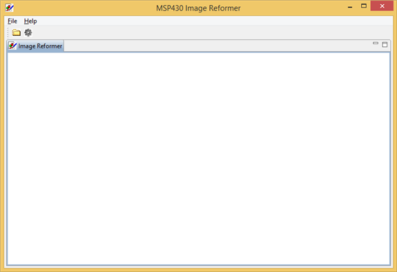

Then launch the MSP430 Graphics Library Image Reformer tool.
On my system, after it was installed, the tool executable was found at:
     C:\ti\msp430\imagereformer_1_00_00_00\imagereformer.exe
Once the Image Reformer Tool is launched, you will get a blank page.
From the 'File-Open Image' menu option, find your bitmap file and open it.

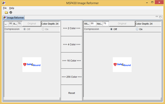

The image should be shown on both the left and the right screens.
From here,you can set the Width, Height, Number of colors to use and whether Compression is on or off.
For the Sharp 96x96 LCD, I found  the following settings to work best:
  • Number of colors - 2 Color
  • Width                   - 96 Max
  • Height                  - 96 Max (76 in this case)
  • Compression       - Off
This will change the image on the right to a Black and White Image.
Once the settings are in place, just click on the Gear icon next to the folder icon in the menu bar to Generate the image 'C' code.
This will generate the '.c' file that will be used in the Code Composer Code to display the image on the LCD screen.

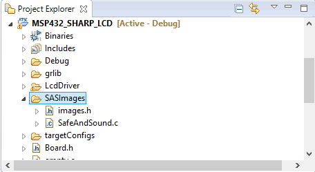

This file can be added to a CCS project such as the MSP432 Sharp LCD example that Jan Cumps outlines:
I added a 'images.h' file to add an interface to the image so I can just include this where I wish to use the image code.
For the Safe & Sound image, the '.h' file looks like this.
 * images.h
 *  Created on: Apr 20, 2017
 *      Author: Jon Morss
#ifndef HGSIMAGES_IMAGES_H_
#define HGSIMAGES_IMAGES_H_
extern const Graphics_Image  SafeAndSound1BPP_UNCOMP;
//extern const Graphics_Image  TI_Logo_69x64_1BPP_UNCOMP;
#endif /* HGSIMAGES_IMAGES_H_ */
To use the image, just include the header file for the image where the image will be displayed.
