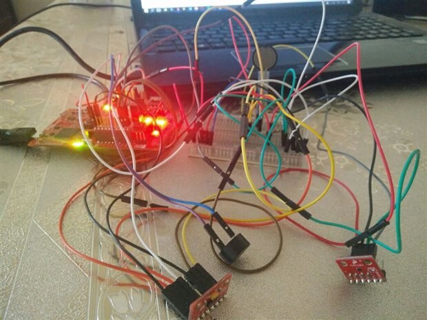

In this article, I will demonstrate the Smart Helmet v0.1 image I am always on the move so I struggle to find time but slowly going further. Let's summarise what have done up to now. I am using TI-RTOS. I stack the Wi-Fi booster pack to MSP432. Connect ADXL345 accelerometer and TMP102 using I2C interface. Detect free-fall, inactivity, and send all the data to Ground Operations Center over Wi-Fi using TCP/IP protocol. I coded Ground Operations Center using C# and it still needs some modifications. DLP-7970ABP boosterpack is connected to Ground Operations Center via UART interface. It controls the gate and doesn't allow unauthorised access and access without the helmet.
In this week, I added a buzzer and pressure sensor. The buzzer is driven by PWM and pressure sensor is read using the analogue input. For pressure, I have used FSR 402 Interlink Electronics. Actually, it is force sensing resistor. It is resistance changes based on the applied force and it is not sensitive but it shows the idea. The code for the ADC? I follow the MSP432 and TI-RTOS: Getting Started Pt. 2 - Add an ADC Sample Task. I create task by code instead of the GUI so the task initialization is as follow
    Task_Params_init(&taskParams);
    taskParams.stackSize = TASKSTACKSIZE;
    taskParams.stack = &taskADCStack;
    Task_construct(&taskADCStruct, (Task_FuncPtr) taskAdcSample, &taskParams, NULL);
I only use the adc0 so I removed the adc1 measurements from the taskADCSample task. pressureAdcValue is where the analogue value is saved. It is then transmitted via Wi-Fi to the Ground Operations Centre with other data.

The next step is adding PWM for the buzzer. Hence, the buzzer sounds pretty awful, I recognise that I need to add some button control to stop it. It is not for the terrible sound of course. There may be cases where the alarm triggered falsely or the miner inform that he got the warning or some other reasons. So how we will do this? There should be a PWM task but duty cycle will change. At first duty cycle is 0 and if the alarm is triggered it will be something valuable like 50.  If the miner press the button, it should be zero again. It looks like there will be message transfer between the task so the answer is Mailboxes. This project is the first time I use RTOS, I don't know there is a better way but  Mailboxes works pretty well for what I want to do. I get great help from Jan Cumps's article MSP432 and TI-RTOS: PID Library Part 2 - Real World Example.
The PWM task is as shown below. It setup PWM and sets the duty cycle 0. Then, it waits for the message to read from Mailboxes. When a message arrives it change the duty cycle.

Where I change the duty cycle is one in ISR of ADX345 and another one is in ISR of the button press.

I was planning to make a video to demonstrate the design but it is so messy now. I will prepare a circuit board then put things inside the helmet. Hopefully, I will publish video next week. What I will do next is modify the program and finish the PC side.

    I2C_transfer(i2c, &i2cTransaction);
    txBuffer[1] = 8;               // Measure
    /***** Give the range settings *****/
    // Accepted values are 2g, 4g, 8g or 16g - ADXL345_DATA_FORMAT
    // Higher Values = Wider Measurement Range
    // Lower Values = Greater Sensitivity
    /**** Activity Inactivity setting  ***/
    txBuffer[0] = ADXL345_ACT_INACT_CTL;
    txBuffer[1] = 0b01110111;
    txBuffer[0] = ADXL345_TIME_INACT; //
    txBuffer[1] = 10;
    /**** Activity Threshold  ***/
    txBuffer[0] = ADXL345_THRESH_ACT;
    txBuffer[1] = 75; // 62.5mg per increment    // Activity thresholds (0-255)
    /**** Inactivity Threshold  ***/
    txBuffer[0] = ADXL345_THRESH_INACT;
    txBuffer[1] = 20; // 62.5mg per increment    // Inactivity thresholds (0-255)
    /**** Free-Fall Threshold and Time ***/
    txBuffer[0] = ADXL345_THRESH_FF;
    txBuffer[1] = 7;  // (5 - 9) recommended - 62.5mg per increment
    txBuffer[0] = ADXL345_TIME_FF;
    txBuffer[1] = 30; // (20 - 70) recommended - 5ms per increment
    /**** Interrupt setup  ***/
    //Interrupt mapping
    txBuffer[0] = ADXL345_INT_MAP;
    txBuffer[1] = 0; // 0b11110011;  //inactivity and free-fall is int1, activity is int2 ( others are int 2 but disabled)
    //Interrupt enable
    txBuffer[0] = ADXL345_INT_ENABLE;
    txBuffer[1] = 0b00011100; //activity, inactivity, and free-fall interrupts are enabled
    /* Deinitialized I2C */
    I2C_close(i2c);
    System_printf("I2C closed!\n");
    System_flush();
    /* Construct BIOS objects */
    Task_Params taskParams;
    taskParams.stack = &taskI2CStack;
    Task_construct(&taskI2CStruct, (Task_FuncPtr) readPos, &taskParams, NULL);
 *  ======== gpioButtonFxn ========
 *  Callback function for the GPIO interrupt on Board_BUTTON1.
void gpioButtonFxn(unsigned int index)
    /* Begin smart config process */
    //smartConfigFlag = true;
    MsgPWM pMsg;
    pMsg.pwm = 0;
    Mailbox_post(mbPWM, &pMsg, 10);
int socketHandler = -1;
int status;
char recievedBuff[4];
 *  ======== TCPsend Function ========
 *  It creates socket, send message, receive it
 *  then close the socket
char* str;
Void TCPSend(char *message)
    char i;
    while (1)
        if (connected != 1)
            // Open WiFi and await a connection
            netIF = socketsStartUp();
            socketHandler = socket(AF_INET, SOCK_STREAM, IPPROTO_TCP);
             * SL_AF_INET indicates using IPv4
             * SL_SOCK_STREAM indicates using TCP
             * IPPROTO_TCP
            connected = 1;
            if (socketHandler == -1)
                System_printf("Error: socket not created.\n");
                connected = 0;
            SlSockAddrIn_t Addr;  // Socket settings
            Addr.sin_family = SL_AF_INET;
            Addr.sin_port = sl_Htons(TCPPORT);
            Addr.sin_addr.s_addr = sl_Htonl(IP_ADDR_Server);
            status = sl_Connect(socketHandler, (SlSockAddr_t *) &Addr,
                                sizeof(SlSockAddrIn_t));
        status = sl_Send(socketHandler, "##*", 3, 0);
        Mymessage = char2str(temperature) ;
        status = sl_Send(socketHandler, Mymessage, 3, 0);
        status = sl_Send(socketHandler, "*", 1, 0);
        Mymessage = char2str(interruptData) ;
        for(i =0 ; i<6 ; i++)
            Mymessage = char2str(accelerometerData[i]) ;
        Mymessage = int2str(pressureAdcValue) ;
        status = sl_Send(socketHandler, Mymessage, 5, 0);
        status = sl_Send(socketHandler, "*--", 3, 0);
        // sl_Close(socketHandler);
        Task_sleep(10);
    // Close the network - don't do this if other tasks are using it
    //socketsShutDown(netIF);
 *  ======== taskAdcSample ========
 *  Open an ADC instance and get a sampling result from a one-shot conversion.
Void taskAdcSample(UArg arg0, UArg arg1)
    ADC_Handle   adc0;
    ADC_Params   params;
    ADC_Params_init(&params);
    adc0 = ADC_open(Board_ADC0, &params);
    while (1) {
        Task_sleep(10);
        /* Blocking mode conversion */
        ADC_convert(adc0, &pressureAdcValue);
    // theoretically close the ADC driver. This code is never reached
//    ADC_close(adc0);
//    ADC_close(adc1);
 *  ======== pwmFxn ========
Void pwmFxn(UArg arg0, UArg arg1)
    PWM_Handle pwm1;
    PWM_Params params;
    uint16_t   pwmPeriod = 2000;      // Period and duty in microseconds
    MsgPWM msg;
    PWM_Params_init(&params);
    params.dutyUnits = PWM_DUTY_US;
    params.dutyValue = 0;
    params.periodUnits = PWM_PERIOD_US;
    params.periodValue = pwmPeriod;
    pwm1 = PWM_open(Board_PWM0, &params);
    if (pwm1 == NULL) {
        System_abort("Board_PWM0 did not open");
    PWM_start(pwm1);
    /* Loop forever incrementing the PWM duty */
    while (1) {
        //Task_sleep(10);
        /* wait for mailbox to be posted by writer() */
        if (Mailbox_pend(mbPWM, &msg, BIOS_WAIT_FOREVER)) {
            PWM_setDuty(pwm1, msg.pwm);
 *  ======== main ========
int main(void)
    /* Call board init functions. */
    Board_initGeneral();
    Board_initGPIO();
    Board_initWiFi();
    Board_initUART();
    Board_initI2C();
    Board_initADC();
    Board_initPWM();
    taskParams.stack = &taskWiFiStack;
    taskParams.priority = 1;
    Task_construct(&taskWiFiStruct, (Task_FuncPtr) TCPSend, &taskParams, NULL);
    taskParams.stack = &taskUARTStack;
    taskParams.instance->name = "echo";
    Task_construct(&taskUARTStruct, (Task_FuncPtr) echoFxn, &taskParams, NULL);
    taskParams.stack = &taskADXL345Stack;
    Task_construct(&taskADXL345Struct, (Task_FuncPtr) ADXL345_init, &taskParams,
    NULL);
    /* Construct LED Task thread */
    taskParams.stackSize = 512;
    taskParams.stack = &taskPWMStack;
    taskParams.arg0 = 50;
    Task_construct(&taskPWMStruct, (Task_FuncPtr)pwmFxn, &taskParams, NULL);
    /* Install Button callback */
    GPIO_setCallback(Board_BUTTON1, gpioButtonFxn);
    /* Enable interrupts */
    GPIO_enableInt(Board_BUTTON1);
    /* Turn on user LED */
    GPIO_write(Board_LED0, Board_LED_ON);
    System_printf("Starting the TCP Echo example for the CC3X00 \n"
                  "System provider is set to SysMin. Halt the target to view"
                  " any SysMin content in ROV.\n");
    /* SysMin will only print to the console when you call flush or exit */
    System_flush();
    /* install Button callback */
    GPIO_setCallback(MSP_EXP432P401R_INT1, ADXL345_int1);
    GPIO_enableInt(MSP_EXP432P401R_INT1);
    /* Start BIOS */
    BIOS_start();
    return (0);
