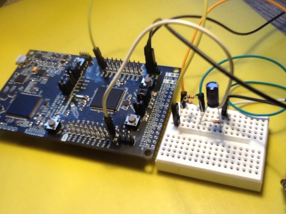

What you need:
  • MSP432 LaunchPad
  • 1 micro-USB cable
  • Code Composer Studio
  • TI-RTOS for MSP43X
  • three 10K resistors and a  4µ7 capacitor (or whatever spare parts you happen to find on your desk)
  • a solder iron or a breadboard with a few wires
  • a voltmeter or oscilloscope (both optional)

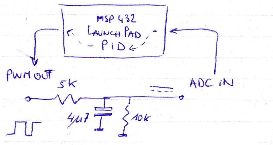

RC Filter
Our MSP432 doesn't have a DAC module. We can't generate an analog value straight away.
It does have a PWM module however. That generates a block wave. We can control the frequency and the duty cycle.
The higher the duty cycle, the more energy our PWM signal holds.
We can use an RC filter to turn that energy into a DC signal. The DC signal's voltage is proportional to the duty cycle of your PWM signal (not to its frequency).

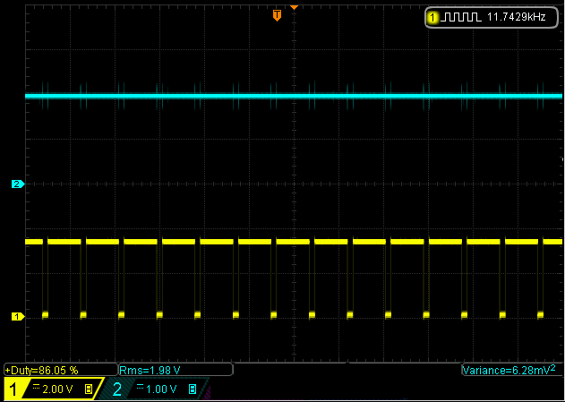

On the scope trace here you can see the yellow PWM signal that's generated by the MSP432. That goes into our RC filter.
The duty cycle of that signal is just a little above 86%.
The blue trace is the DC output of that filter. It's almost 2V.
If the duty cycle of the PWM is set below 86%, the DC signal will decrease. It's at max when the duty cycle is 100%, 0V when the duty cycle is 0%.
The RC filter is 3 components. You have a 5K resistor and a 4µ7 capacitor that filter the PWM into DC.
The 10K resistor in parallel with the capacitor keeps the voltage to the output below the ADC reference (together with the 5K resistor it acts as a 2/3 voltage divider). It's also a bleeder resistor that discharges the capacitor when you disconnect the filter from its input for some reason.
You can make the 5K from two parallel 10K resistors. That keeps the BOM down to a single very common value.
These values aren't critical at all. Anything that's in the ballpark of what I'm showing here will work.
You can also change the PWM frequency if you have different components lying around.

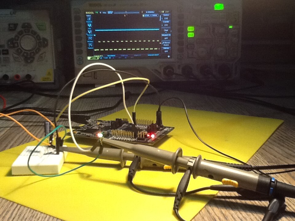

Connect the input of the RC filter to the output of your LaunchPad's PWM signal. We will use P2.6.
Wire the ground of the filter to one of the many ground pins on the LaunchPad.
The output needs to go to P5.5,
You can check in the PWM and ADC setup sections later in this blog how and why these pins are configured and used.

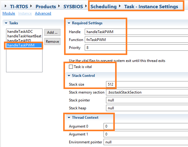

The TI-RTOS FirmWare - Synchronise with Mailboxes and Events
The CCS project is attached to this post. You can us it to check out some neat RTOS techniques: Messaging, Events and Synchronisation.

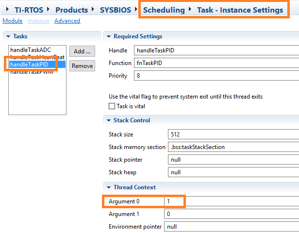

There are three tasks.
  • PID task manages everything. It's scheduled to run at a given interval by the TI-RTOS.
    It asks samples from the ADC module and tells the PWM task to change its duty cycle.
  • The PWM task sleeps until it gets a command from the PID task to change the duty cycle.
  • The ADC task sleeps until it gets a nodge from PID to give the sampled DC value.

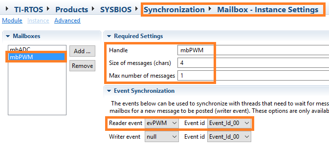

Message and Event
We're using the Mailbox functionality to exchange the data between the two tasks. Mailbox has synchronisation built in.
You can let a task wait until it's either told to read a message or write one.
The PID task that's scheduled by the RTOS is the one that tells the other tasks to do their work.
The PWM task sleeps (idle, no cpu time consumed) and waits for a read event.

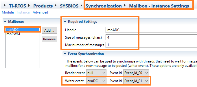

The ADC task sleeps, unless there's a place on the message box (and there's only one place available) to write data.
    while (1) {
        /* Blocking mode conversion */
        ADC_convert(adc0, &adcValue0);
        msg.adc = adcValue0;
        /* enqueue message */
        /* wait for mailbox to be read by reader() */
        Mailbox_post(mbADC, &msg, BIOS_WAIT_FOREVER);
The PID task will make a place available in that mailbox by reading the available message.

A full cycle of the PID task is:
     while (1) {
         Task_sleep(((UInt)arg0));
         if (! Mailbox_pend(mbADC, &aMsg, BIOS_NO_WAIT) == 0) { // no sample
             Input = aMsg.adc; // todo set to same base as output
             // some calculations that you can check in the source code are removed
             if (pidCompute()) {
                 pMsg.pwm = trunc(Output);
                 Mailbox_post(mbPWM, &pMsg, 10);
The messages are a very simple structure that we define ourselves:
typedef struct MsgPWM {
    uint32_t pwm;
} MsgPWM;
typedef struct MsgADC {
    uint32_t adc;
} MsgADC;
Their size is important, because the Mailbox mechanism makes a byte per byte copy of them when sending and receiving.
You can see in the screenprints of the Mailbox setups above that I enter a char size of 4. That's because the structure of the message contains one 32 bit value. That's 4 chars.

This task isn't scheduled to run at regular times in RTOS. It doesn't use the Task_sleep() function like the PID task.
That's because the Message Box schedules it.

The RTOS configuration for the task is identical to that op the PWM job.

You can hook up a voltmeter over the output of the RC filter and measure the output level.
If you want to check out what's happening with a scope, the interesting signals are the filters input (PWM signal) and output (DC with ripple)

    Here we go.
    I kept the same resistors as in your design, capacitors are half of your value (100n instead of 180n) which moves the frequency out to 20kHz .
    Diagrams:
    (I used 2nd order CR filter Design tools )
    The PID manages to keep up - I've stretched it to the level that it had to supply 95% duty cycle.

    Would it be alright if I make an observation here? You'd do much better with a second-order filter (it only adds two more components).
    Here's your filter circuit
    this is the frequency response
    you've had to position the -3db point at 10Hz to get a response that's down by 60db at the PWM frequency in order to make the ripple reasonable - here's the ripple
    but with the -3db point so low the transient response is poor
    Here's the circuit of a second-order filter. I've chosen the values so that the -60dB point is roughly similiar, so we should get about the same ripple
    here's the frequency response
    the ripple is similar
    but now look at the transient performance - it's about ten times better. Much more agile and responsive - though it does mean your loop tuning will be more challenging to control it.
