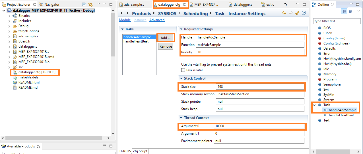

Then add the task to the RTOS configuration. Open the editor by double-clicking datalogger.cfg.
Save all files and rebuild.

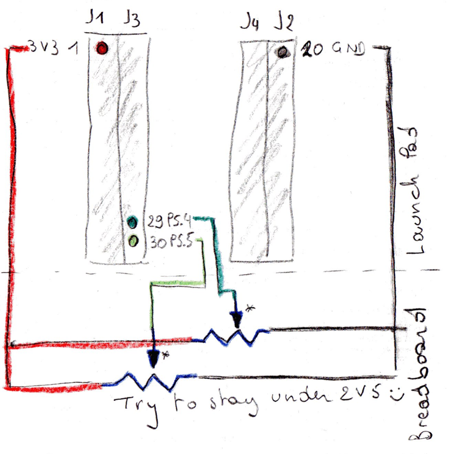

Hardware
Put your two potentiometers on the breadboard. Their value isn't that important. Anything between 10K and 1M is certainly ok. They don't need to have the same value. Whatever you have at home.
We'll use them to divide the 3V3 level of the launchpad, and send the value at the potentiometer's wiper to ADC0 and ADC1.
Wire the 3V3 of your LaunchPad to one sie of each potentiometer, GND to the other side.
The wiper of one goes to P5.4 and P5.5.
Set both potentiometers to the middle, plug the LaunchPad in the USB and start a debug session.
You'll see the values appear in the console.
Turn the potentiometers to see the values change. Once the wiper is above the reference value 2.5V, the results will not change because you've overrun the range.

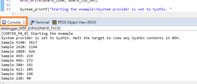

Result
[CORTEX_M4_0] Starting the example
System provider is set to SysMin. Halt the target to view any SysMin contents in ROV.
Sample 5140: 3617
Sample 2620: 1194
Sample 1084: 426
Sample 459: 219
Sample 466: 272
Sample 380: 191
Sample 412: 205
Sample 380: 198
Sample 220: 90
Sample 220: 118
Sample 348: 303
Sample 259: 215
Sample 188: 91
Sample 211: 123
Sample 380: 223
Sample 233: 137
Sample 316: 165
Sample 252: 97
Sample 444: 209
Sample 230: 94
Sample 261: 61
Sample 380: 130
Sample 412: 211
Sample 207: 103
Sample 252: 95
Sample 252: 136

    •         System_printf("Sample %u:%u\n", adcValue0, adcValue1);
    •         /* SysMin will only print to the console when you call flush or exit */
    •         System_flush();
