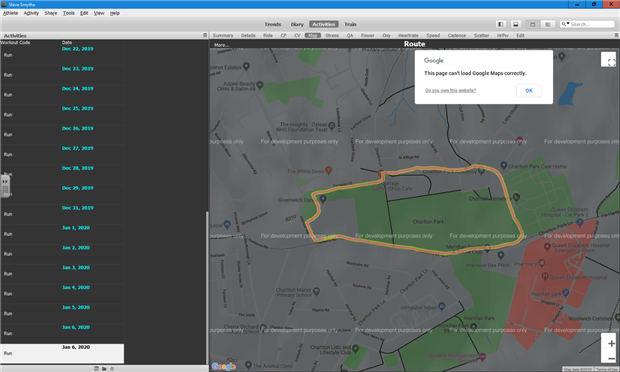

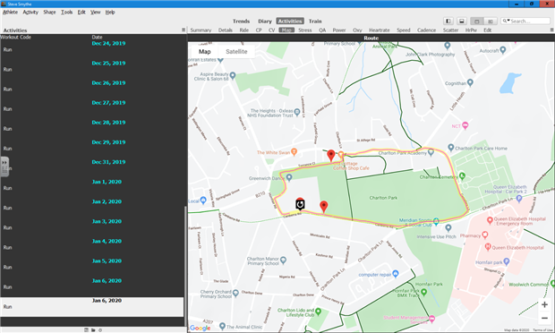

And so on to GoldenCheetah. I downloaded the latest stable version (3.4) and all looked good until I tried to load any route maps.
I am familiar with this error, which arises because Google now require you to enter an API key if you want to use their mapping api. I couldn't see a way to enter my personal Google Maps api key into GoldenCheetah. In GoldenCheetah there is an option to use OpenStreeMap instead of Google Maps, so I tried that but strangely I still got the error! After a bit of Googling, I found that GoldenCheetah has a version 3.5 under development (downloadable at your own risk) that allows you to enter your Google Maps api key (which I already had), so I tried that. Result!
After spending some time looking at the software, it looked like GoldenCheetah would potentially meet my minimum Requirements (just to replace SportTracks) as set out above. The next step was to do some testing. (Once again, I shall spare you most of the details).

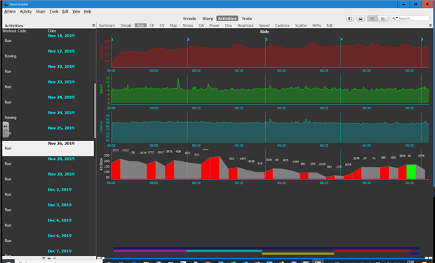

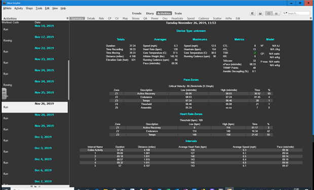

The first test was simply to attach my Garmin 220, import the data, and see how it ends up in GoldenCheetah. I'd already imported a few activities when testing out the mapping function but I was interested to see what analysis and reporting I could get from those activities. Here's an example screenshot of a summary of a single activity.
and some of the charts
It is clear from this that:
a) The GoldenCheetah people love statistical analysis. You name it, they've got it!
b) The software is very cycling-oriented. I don't mind this, but I had to look quite hard to see how to make the reports on running activities more meaningful for me (e.g. I want pace to be measured in minutes per mile, not miles per hour (which is what cyclists use). The good thing is that you can configure different units on a "per activity" basis.
