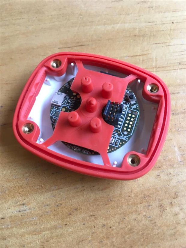

By Blog #4, time was running out and I still hadn't received my kit but, because I wanted to finish the project before the Challenge closing date, I temporarily retrieved my RoadTest RSL10-SENSE-DB-GEVK kit from where it had been deployed. This allowed me to test out some potential "wearable" enclosures for the RSL10-SENSE-DB-GEVK device. I was very satisfied with the enclosure that I had found.
If anyone is interested, this enclosure costs around £8.50, and the clip set is around £3.00. If you wanted the wrist strap, it is around £9.00. Volume discounts are available. (n.b. I have no connection with OKW Enclosures).

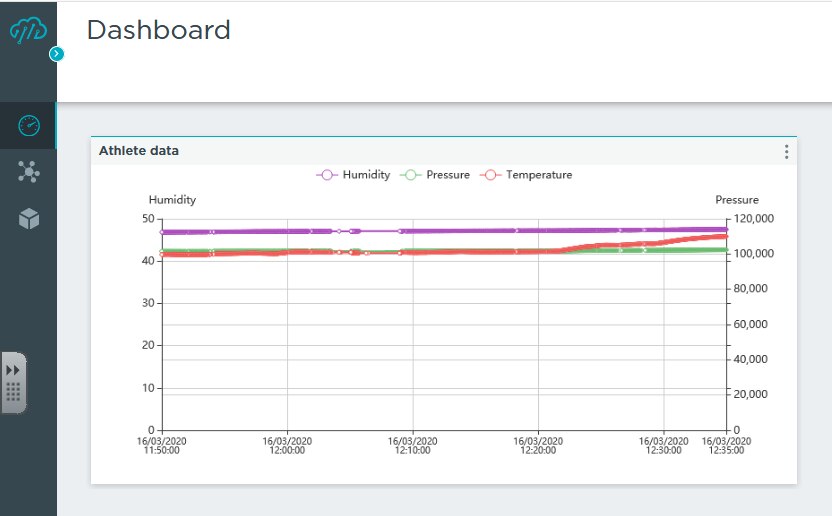

I am pleased to report that, from a data collection point of view, everything worked well. On a couple of occasions, data transmission to the Atmosphere IoT cloud was interrupted for a short while. This could either have been an interrupted BLE connection or loss of 4G signal. However, on both occasions, it recovered itself.

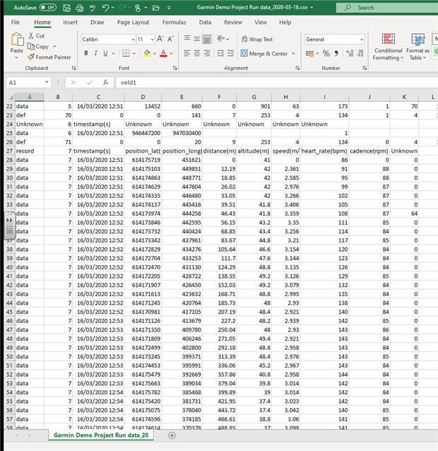

Here's a screenshot of some of the Garmin data in Excel format. The whole data set is several hundred rows.

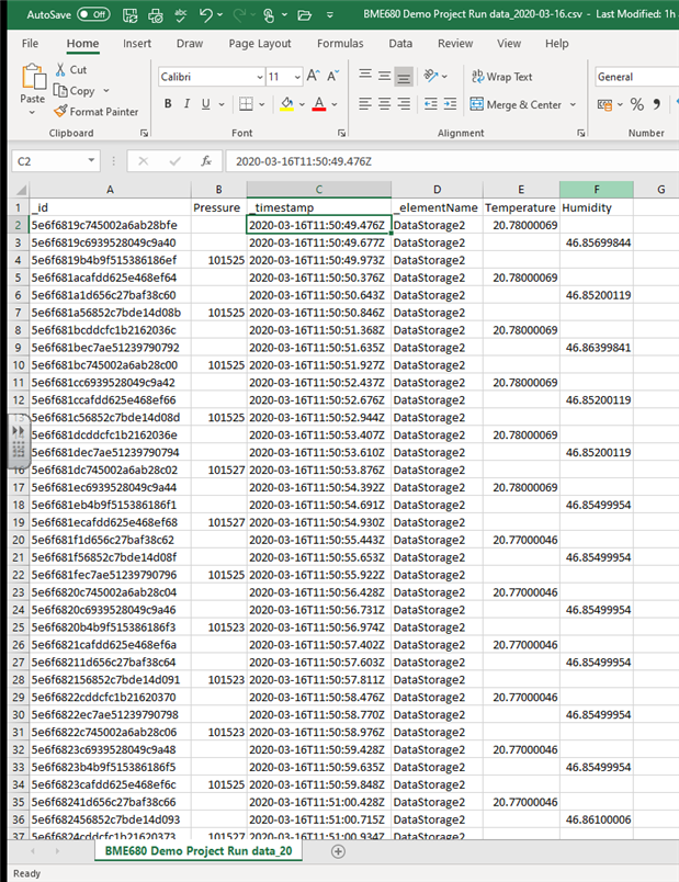

And here's the sensor data for the same timeframe in csv format, downloaded from the Atmosphere cloud.
I noted that the timestamps for the Garmin data are late by exactly one hour (although the time shown on the watch is correct). I don't know why that is bit I'll have to bear it in mind when I import the sensor data into Golden Cheetah.
