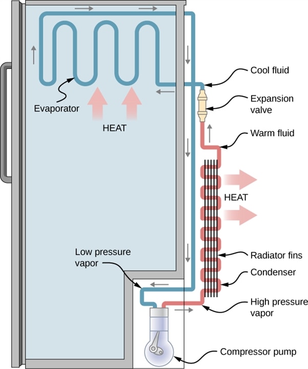

As proposed in the previous blog post, I will investigate the possibility of turning home refrigerator into energy storage device, storing excess energy as cold, which hopefully will limit it's energy consumption during other parts of the day. To make things easier (and stick to this design challenge's theme) I will investigate using old (which usually means - simple)  construction, probably scheduled for replacement in many households. This way, if everything goes as planned, not only some energy consumption optimization will be obtained, but old appliance saved from recycling.
Let's start with refrigerator's construction analysis that will tell us how difficult will be implementation of external control mechanism.
Home refrigerator construction
Most common home refrigerator type is a compressor based one. It's working principle describes the following diagram and description (obtained from https://phys.libretexts.org with accordance to the CC BY 4.0 license)
A schematic diagram of a household refrigerator. A coolant with a boiling temperature below the freezing point of water is sent through the cycle (clockwise in this diagram). The coolant extracts heat from the refrigerator at the evaporator, causing coolant to vaporize. It is then compressed and sent through the condenser, where it exhausts heat to the outside.
One element omitted in this description is a thermostat that is controlling compressor operation - switching it on when temperature inside is too high and switching off when temperature lowers sufficiently.
