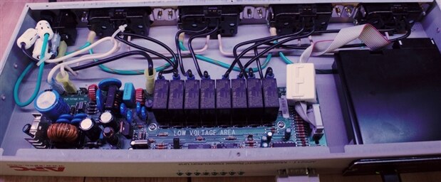

    Based on the pictures I would tend to try and keep the existing power control board, it looks like it already has the power rails you would need, for sure there is 24V available as that is the rating for the coils of the relays.
    The board looks like it would be easy to isolate the relay drive and inject your own from whatever controller you want
    Keeping the existing board would be the safest thing too as @MCB1 has already stated, it looks to be well designed and has good clearances from mains to low voltage control side, you would be hard pushed to find this with cheap ebay specials.

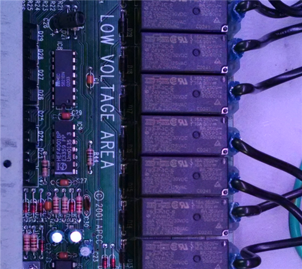

    mcb1 over 9 years ago in reply to jasonwier92
    jasonwier92
    Well done on the investigating.
    The voltages you see suggest an open collector device is driving the relays, and the datasheet below confirms that.
    http://ww1.microchip.com/downloads/en/DeviceDoc/mic5821.pdf
    As you can see on the board, they have gone to great lengths to seperate the high voltage (mains) from the low voltage side, and that will include earth planes, etc.
    If you can replicate the signal required to dirive the latches, then you've eliminated a lot of physical work.
    The 12v could be used to power the Edison, and the 5v is the chip drive voltage.
    Be aware that the native Edison is 1.8v I/O so you'll need to use the Arduino Breakout board or some interface to drive the chip.

    I will use the idea of using the board as my second BLOG entry soon.  Here is what I have found so far and I do not have a scope to look further into what signals are coming out of the management card. I have scoped out the 14 pin header going to the 20 pin management card and it has two grounds, 5, 12, and 25V.  Then the other pins go to the array of resistors (8 of them) and they have different voltages on them.
    The relays when the outlets are off have 25VDC to them.  When turned on there was 0.7VDC on the one end of the diode I was testing at.  I traced that back to a MIC 5821, which is the 8-bit latched driver that controls the relays.  It can handle 25VDC and data is read in serial with a clock. So I could write to it with the Edison.  The other chip is a Quad NOR, not sure yet what that is used for. I would assume the management is putting out a clock, Data, and Output Enable (OE).
    The low voltage part of the board has three different voltages DC: 5, 12, and 25.
    When I unplug the management card, the serial stops working.  I think a blank has to be in the management port to signal that it is empty.  I will continue to research this option.
    It would not be hard to wire this up to safely replace the 8 port relay with a opto isolated board and put in a nice 12 VDC power (5V step down too if needed). I will keep both options open for now.
    mcb1 over 9 years ago in reply to COMPACT
    Agreed.
    Also a Solid State Relay will not allow dimming.
    Personally I'd be taking a second look at the existing power board side of the unit.
    It has all the safety design already done, and you might be surprised how easy it is to interface.
