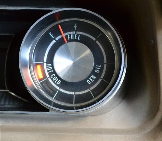

Vehicle Temperature Light
For the cheaper model vehicles the manufacturer may have had a light on the dashboard that came on when the vehicle reached a certain temperature.
Photo Three minions me, myself and I
The principle is simple.
12v is fed to one side of the lamp, and the other side to a temperature switch which closes when the temperature exceeds its value, the circuit is closed and the lamp illuminates.
There are three issues with this design :-
1. The wire might fall off/break.
2. The lamp may fail.
3. The water departs the radiator via a leak and the temperature never reaches the switch value.
In each case the light never comes on and you're none the wiser until it stops and the expensive repair ensues.
So I decided to use an Arduino and an analogue sender unit and connect them between the lamp and the engine.
When the vehicle was started, the Arduino checked it could see the sender unit (ie some resistance), and it would come on solid for a few seconds.
If it detected the temperature was below the normal range, it pulsed as it warmed up.
As it reached a normal temperature, the lamp went off, but If the temperature got to 90C (10 degrees off boiling) it would flash, and if it reached 100 it would come on solid.
Here in NZ our temperatures are never extreme so we can easily run a 83deg C thermostat and if the cooling system is working you should only ever see the 'check light', a pulsing light and then nothing.
In case you're wondering this 60's classic was an export model that was assembled in Canada, so the COLD light was never fitted, but it shared the same dashboard as other GM vehicles assembled in Canada
So that is an Electronically Upcycled Temperature Lamp.
