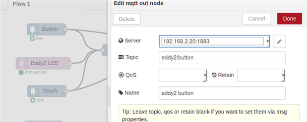

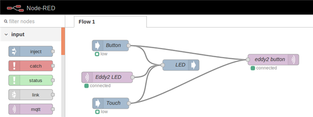

Here is my example to test.  I have GPIO inputs of Button and Touch that output to the LED.  If the button is pushed or the touch sensor touched the LED turns on, very simple. If the button is released or the touching stops the LED turns off.  But also those messages are sent out MQTT (eddy2 button).  Also I have the MQTT input, "Eddy2 LED" that I can send a 0 or 1 to to turn off or on the LED respectively.
Here is my "eddy2 button" setup.
