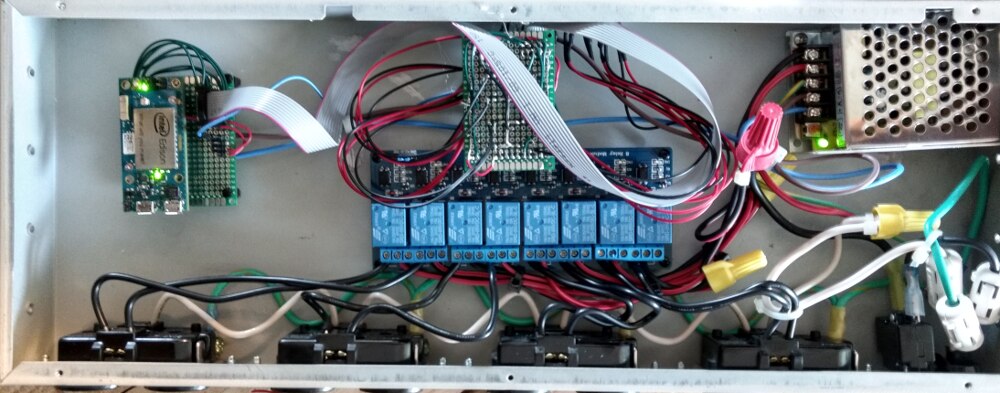

A Time to Dance
This is good.  My project has come together and works.  I like it. Now as many have said it is time to add in the extras I wanted to do.  I have decided to put this device in my NEMA box at my 80' tower. Then when I have a problem, I can power cycle items. Another goal will be watchdogs to reboot radios if the tower cannot see inside my network.
Special thanks to Intel!!

Okay, I am short one item in my Upcycled PDU that I wanted.  The LCD in he kit was too tall to fit in my box. Not a huge deal as I will use the other Edison to drive the LCD and some other add on items.  I think I will put it in a project box and it will be the part of the project that is shown.
Forward With Time to Keep
This will be a 10,000 foot view and I will zoom in on parts to follow.  The web interface is working how I want it, but I want to to look good, so I will cover that as I finish it too.  Also the second Edison control and display functions will be covered with the details.

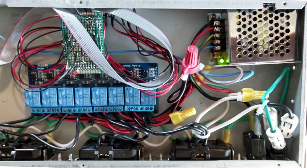

Full Inside View
Right Side
Left Side

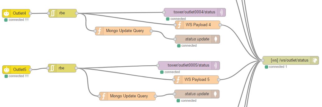

Node-Red Flows!
{gallery} My Gallery Title
Incoming WS message for outlet control and MQTT to also control the outlet.  I need to change put a function so that I can send On/Off via MQTT from Home Assistant.
Long flow that looks for GPIO status and looks for changes.  Then send out a MQTT message (needs a function also for On/Off from 1/0), function that formats what outlet is sending to a WS, and update MongoDB entry.
More detail on the last slide.
When there is a new connection or Home Assistant starts up, we need the status of all the outlets.  This flow looks for that query and sends out via MQTT and WS.
