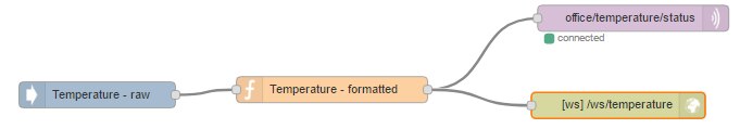

Here is how this is all done. Node-Red reads, converts, and reports the temperature via MQTT and Web Sockets (WS). Then Home Assistant reads and displays this value. Also I have automation setup to turn on and off the fan. Lets break down the parts.
Node-red
Here you can see the Temperature is being read, then formatted to Celsius and Fahrenheit.  The sent back out.  The conversion looks like this.
var retMsg = {};
var a = msg.payload;
var B = 4275;
var R = (1023.0/a - 1.0) * 100000.0;
var tC = 1.0 / (Math.log(R/100000.0) / B + 1 /298.15) - 273.15;
var tF = Math.round((tC * 9 / 5 + 32) * 100) / 100;
retMsg.payload = {
    tempC: Math.round(tC * 100) /100,
    tempF: tF
return retMsg;
Then I publish to the MQTT channel and the WS.  What goes out is JSON with both values in it.

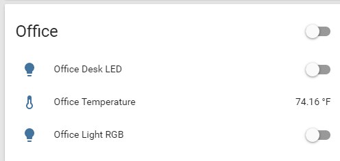

Sensor in Home Assistant (HA)
Next I setup the sensor in HA. The tricky part is getting the value out of the object that I want to see. I would setup Fahrenheit for myself, but my Dad would like to see Celsius.  Here is the sensor config:
- platform: mqtt
    state_topic: "office/temperature/status"
    name: "Office Temperature"
    qos: 0
    unit_of_measurement: "°F"
    value_template: "{{ value_json.tempF }}"
and here is what it looks like in HA:

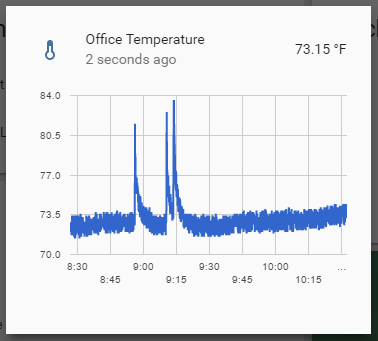

Click on it and I see:
You can see my history of doing tests of the fan.  I have thought about taking ten samples, taking out the high and low and averaging the rest of the values to report a more steady temperature.
