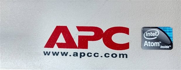

Before I started this challenge, the PDU was in working condition. It could be controlled remotely by telnet, http web interface, and SNMP.  My goal was to make it into something that can be used with today's standards and more.  Lets move through some of the objectives, with a why and how.

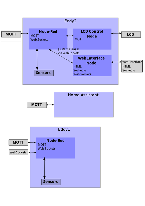

Final Block Diagram
Eddy1 is in the PDU and controls the relays/outlets.  Eddy2 is in the cardboard box, yes I need a home, but I have not found a home cool enough yet. Home Assistant is running on another system that I use to automate lights and other items in the house.

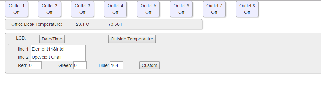

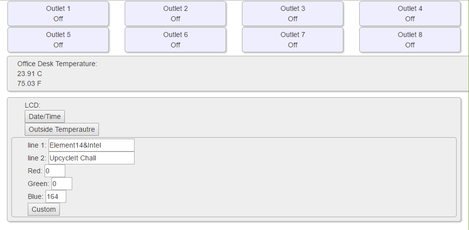

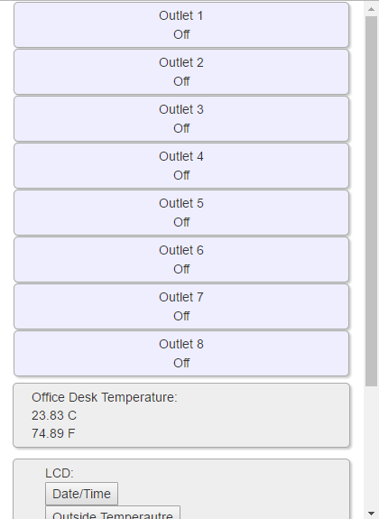

I wanted to show the web interface and LCD display.  First of all here is the web interface. It is responsive, so I showed a shot of three views, desktop, tablet, and phone.
Desktop View
Tablet
Phone

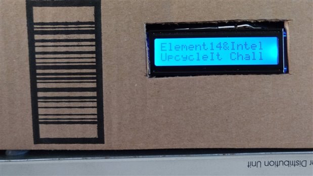

Then you will notice that there is a LCD sections. Before all that worked was selecting the Time or Temperature to the LCD.  Now I have custom messages.  So the one shown, comes to the LCD looking like
