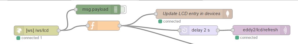

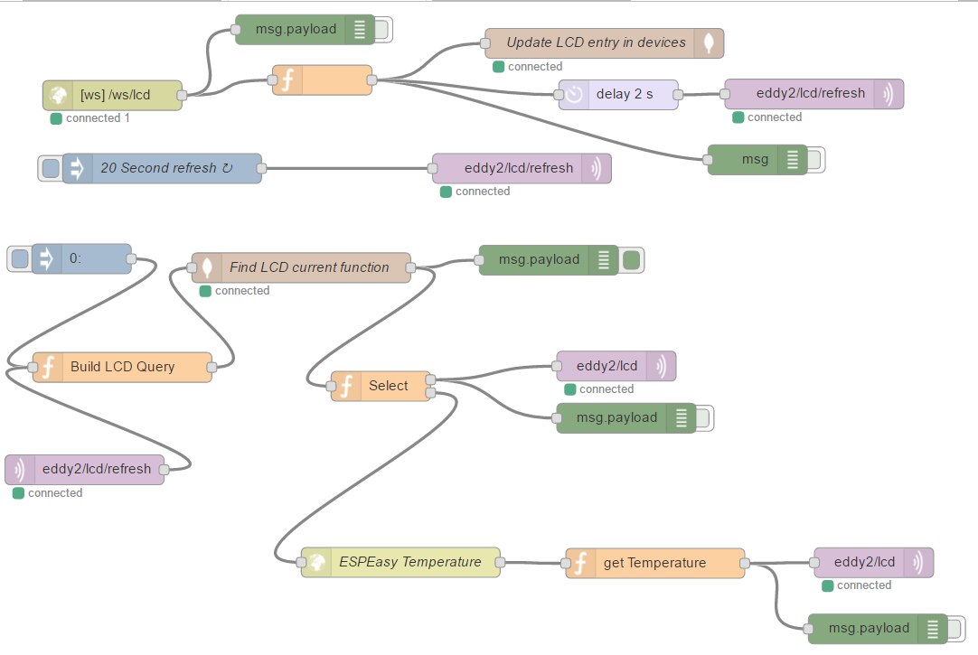

First lets look at the top flow:

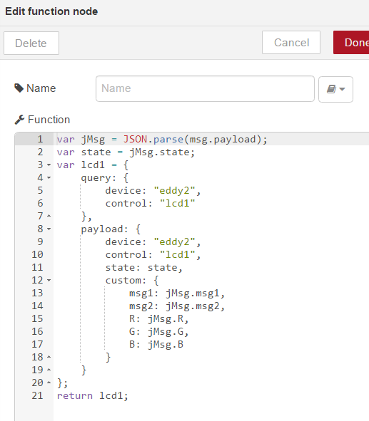

  1. If we get a WS mesage to /ws/lcd, it should be a message to update what is shown on the LCD.
  2. The second node is the function node and this takes the message and creates an update query for the mongo.  Looks like this:
  3. The third node updates the mongo collection
  4. There is a 2 second delay to make sure mongo is updated and then send out a MQTT message to update the LCD, which we will cover below
Regular Updates
Next up is simple: Every 20 seconds ask the LCD to update.

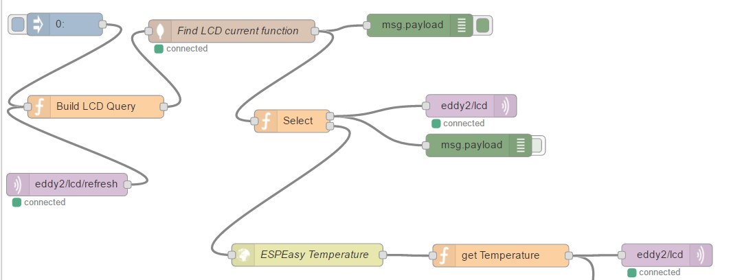

Show Me the Message:

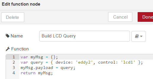

Last set of Nodes in this flow take the MQTT message, query mongo for what should be show and then display that.  I covered much of this in my last BLOG post #6 for the Upcycle It Challenge. Here what the query looks like:
And my function
