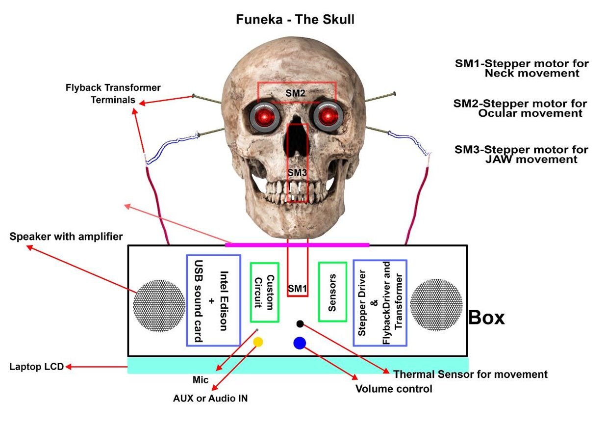

I just planned to make a talking skull, that would recognize  voice commands and reply Unread Gmail count, Temperature, Humidity etc. Sounds like the usual stuff? There are some more fun too. How about some motion tracking eyes that glows blue( I couldn't find blue ones for the pic image) , a cool night lamp and some LEDs and High Voltage Arcs* that reacts to audio?
The Intel Edison is kept inside a box and the plastic skull is place over it, it measures temperature humidity and unread gmail count. The USB audio card will help in bridging the microphone and speakers to the Edison board. The Intel Edison looks for programmed voice commands, and gives a reply back.
For example.. key words like "any mails?" will give out a reply as "you have 'x' numbers of unread mails."
The jaw movements of the skull are synced to the speech audio with the help of the stepper motors salvaged from the CD drive.
A I2C MEMS thermal sensor(Omron  D6T-8L-06D6T-8L-06 will look for thermal signatures and movements if any movements are detected the eyes will start to follow the motion(Ocular motion will be only in horizontal direction since the thermal sensor resolution is 1x8

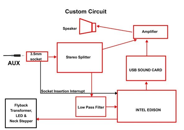

AUX option will be added using a custom PCB , which splits the audio to Input of the Amplifier and Analog pin of Intel Edison through a low pass filter,so that the skull is made to move only to Bass and The fly-back transformer* will be turned on only after a specific of magnitude of the analog signal (need to try and choose which value gives a good effect). When aux is used the other options will be disable and some reactive LEDs inside the box will illuminate the Skull for the beats.
The LCD from the laptop will be used as cool under glow and will work as a night lamp too. All circuits and components will be shielded away from High voltage.
