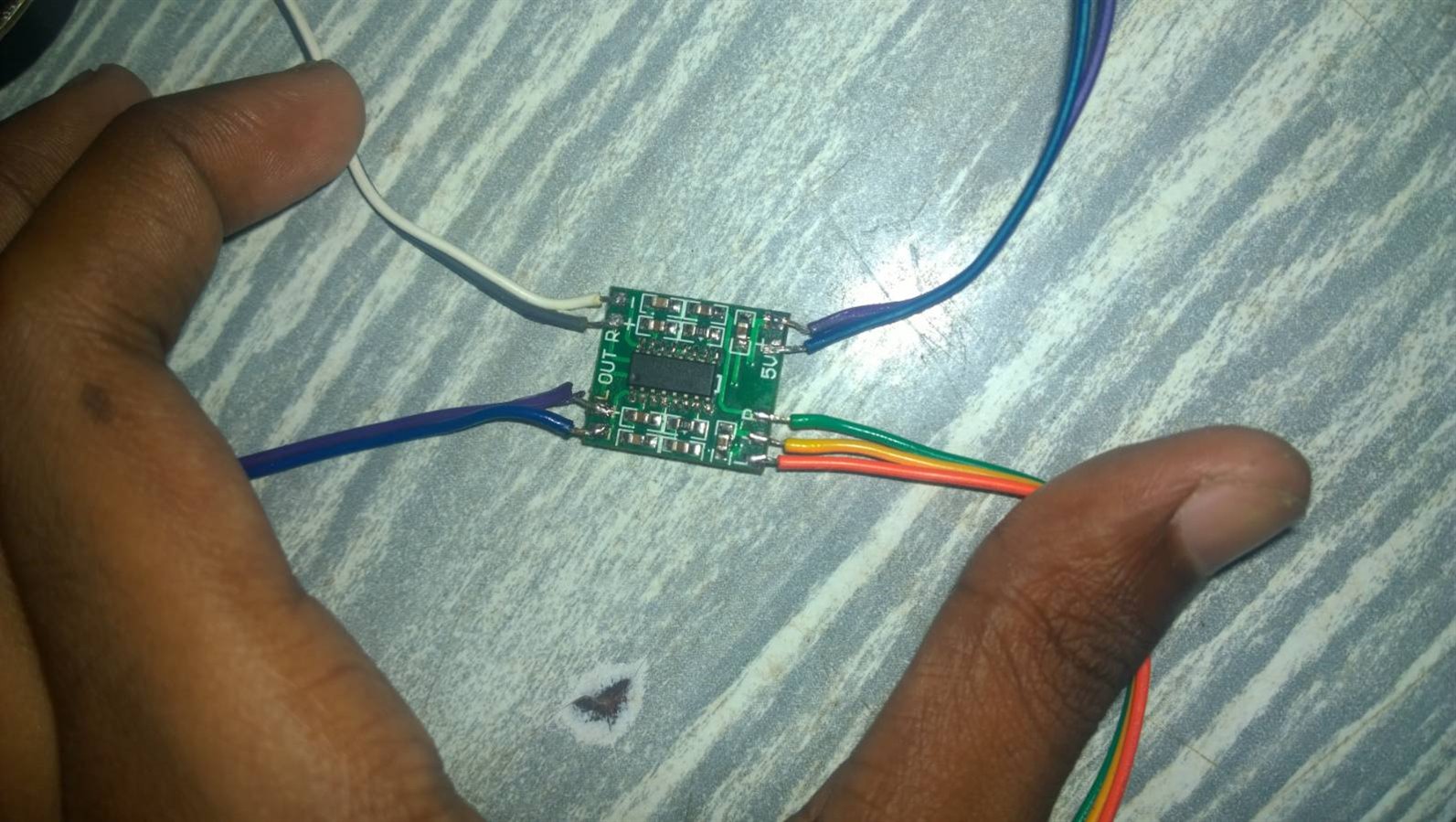

Hi guys,

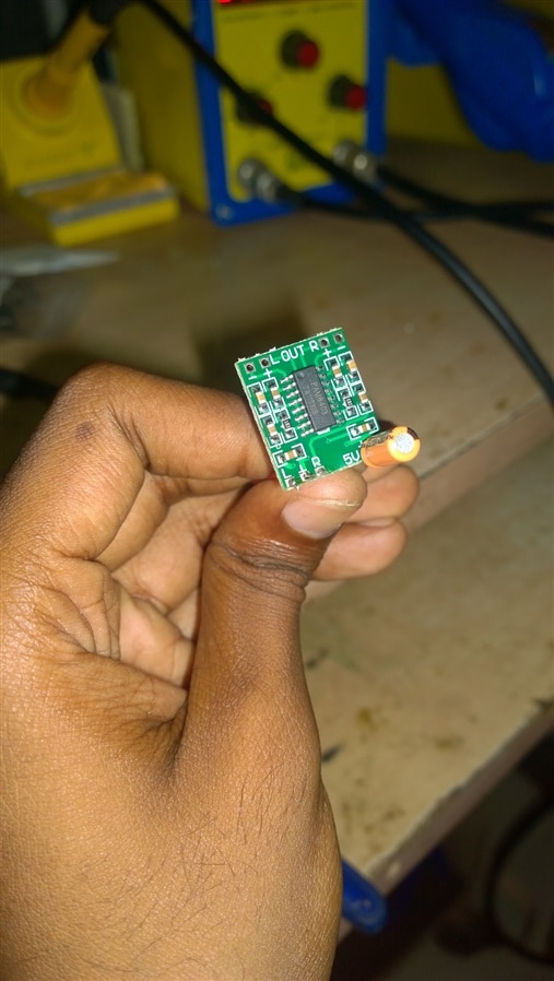

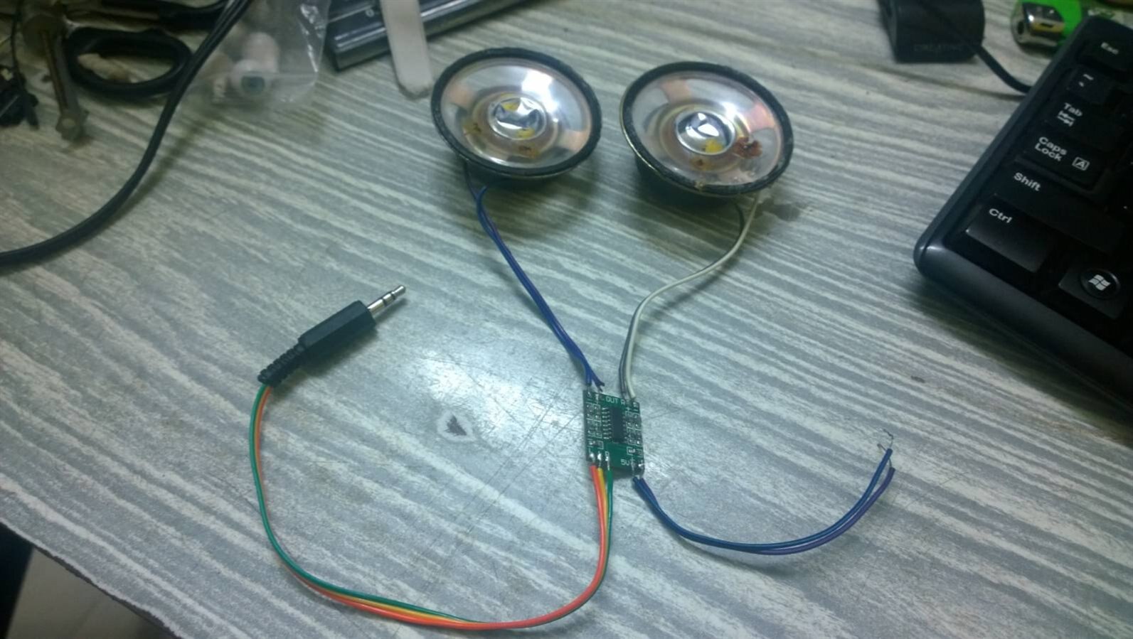

So planned out things... So started with the Amp and the Speakers.
The Amplifier board is based on PAM8403, which says its a Class D Amplifier with a 3W + 3W Output.
The speakers were from Radioshack, Each 4Ω.
Started to solder out.
A bit of soldering, Low pass filters and some testing....
Things were smooth till I smelled it, Yep the Amp-IC was about to burn, the output terminals were short.
Hopefully I had a spare Board (Still I have no Idea why I had two, anyway everything happens for good).

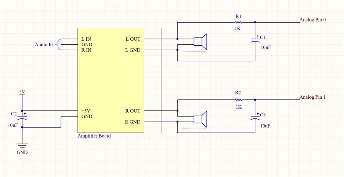

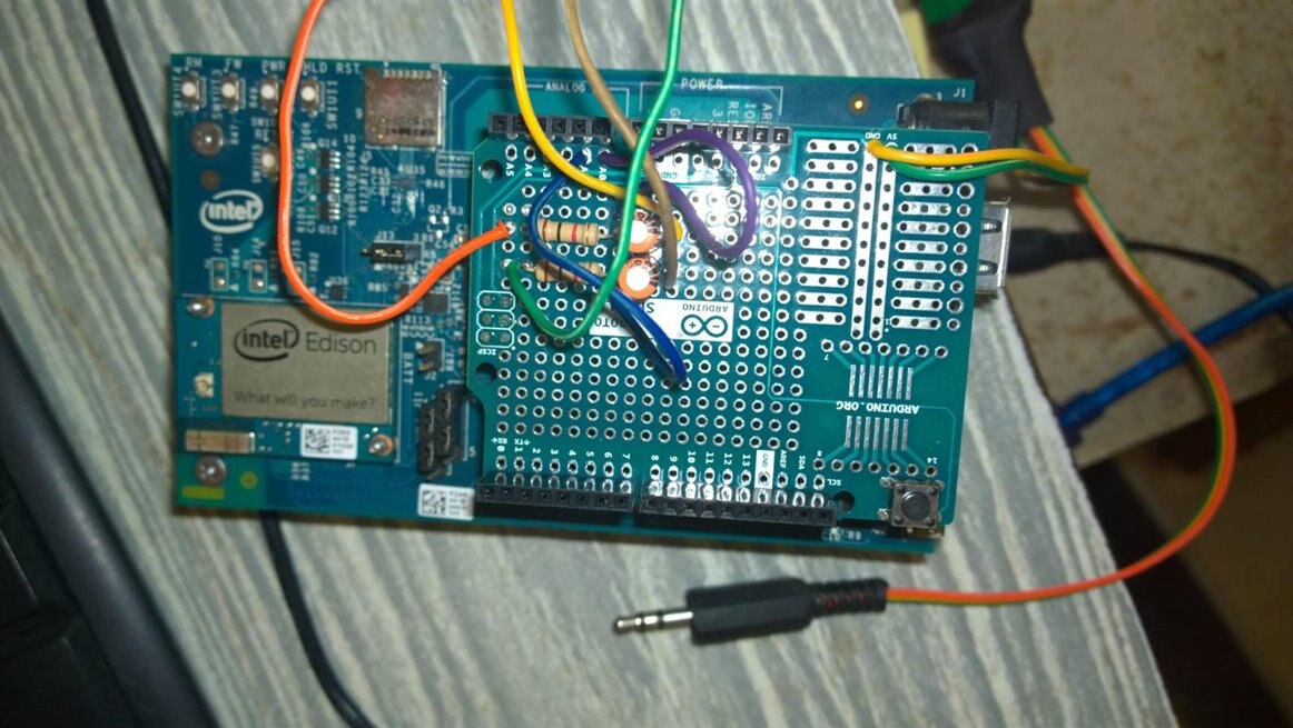

So this time I use a Filter Capacitor for Input Power. and soldered all the components in the ProtoShield which came with the kit.image
Do not short the Left Ground and Right Ground with the power or Edison's GND, these are Completely Isolated and are Connected Internally in the PAM8403.

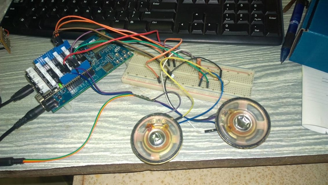

Fed the audio signal into the Edison so it could turn on a few Led which will be replaced with EL wire, Just waiting for the EL sequencer to arrive.

    Nice update and lesson to others. Always check for shorts before applying power! I do like the simple circuit and light response. Looks cool. It will be very nice to see this circuit integrated with the…
    mcb1 over 9 years ago +1
    You wouldn't be the first to assume the speaker ground is the same as the supply ground. Is it just me or is there no video in the attached video, it plays and there is sound but no picture. Mark
    Always check for shorts before applying power! image
    It will be very nice to see  this circuit integrated with the skull.
