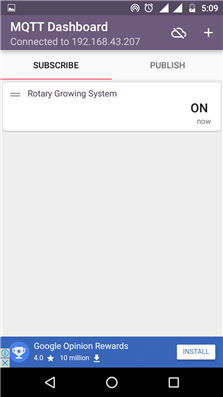

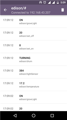

We started assembling and flashing the board following Intel instructions at https://software.intel.com/en-us/get-started-edison-windows
As the idea is to get feeds from the rotary grower and be able to change settings such as drum rotation and grow light time on/off periods we have to run MQTT broker and client.
At this stage, the broker will be only accessible on the local network but later I will set up a DNS server so we can access it from everywhere.
Building and Running Mosquitto* MQTT on the IntelRegistered Edison board
There are some tips on how to install it on the link below; however, the current version is mosquitto-1.4.12.tar.gz
https://software.intel.com/en-us/blogs/2015/02/20/building-and-running-mosquitto-mqtt-on-intel-edison
To have the sketch running from boot and initialize the mosquitto broker I used the script below
#File: /etc/init.d# vi automateSketch.sh
exec /sketch/./sketch.elf foo bar &
 exec mosquitto -d
Make the script executable by changing the permissions with chmod
root@edison:/etc/init.d# chmod +x /etc/init.d/automateSketch.sh
root@edison:/etc/init.d# chmod +x automateSketch.sh
To have the script executed every time Linux boots
root@edison:/etc/init.d# update-rc.d automateSketch.sh defaults

On my mobile, I installed MQTT Dashboard so we can get the feeds and publish values such as Light Time Set On/Off and  Drum RPH (Rotations per hour)
