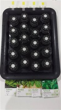

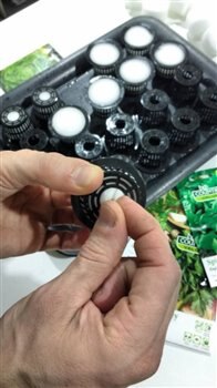

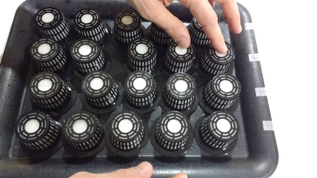

Preparing the growing baskets
The seeds are placed in a cut on the foam.
I am testing Lettuce, Parsley, Rocket and Spinach all in one go.

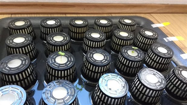

So far this is what we got. I will place them in the drum as soon as I have most of them germinated.
