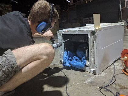

While we wait for our Intel Edison Kit, we started preparing the washing machine to become the rotary grower.

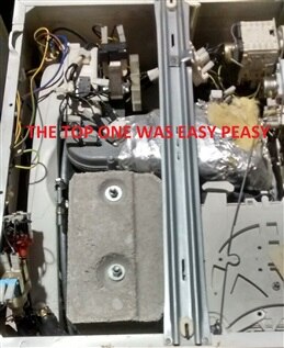

The first step was removing the counterweight. As a rotary grower, the drum will turn at a very low RPM so no need for those 2 pieces of concrete weighing more than 20kg. We thought that would be the easiest part of the project. However, due to rust and hard access to the bolts, we had no other option than using a grinder and a jackhammer in order to get rid of this dead weight. We can say this is the first electronic project we had to start with a jackhammer. It was a good fun, though!

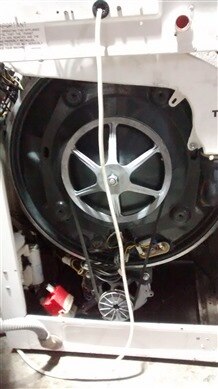

Next step is removing everything else we are not using. We are keeping all relays, solenoids and water pump aside as they might be useful later on on the project. The plan is using the original motor and the variable speed controller but we first need to check if we can get to the low RPM required using the original components.
We hope to have the heavy job completed this week so we can start working on the sensors and interface with the Edison Kit.

    A second drum pulley and motor pulley might be enough. You probably need to measure the current speed, and the desired speed to see what reduction you need. Pity it wasn't the gentle Annie style with a…
  • nandohila
    nandohila over 9 years ago in reply to mcb1 +2
    A multiphase motor would be great. However, this motor is connected to a controller and there are lots of wiring coming out of it. After identifying the wires we I might be able to set the slowest speed…
  • nandohila
    nandohila over 9 years ago in reply to Workshopshed
    We realised that we would need a gearbox in order to reduce to the required RPM. Maybe it would be easy tapping into a controller of a new washing machining model, but the asynchronous motor we have has no torque once the speed is reduced.
    We are testing a printer step motor so we might be able to turn the drum at low and controlled speed without the need of complex reducing gear. It also will use much less energy.

    A multiphase motor would be great. However, this motor is connected to a controller and there are lots of wiring coming out of it. After identifying the wires we I might be able to set the slowest speed and see if it is possible to have it reduced even more through pulleys. The last option will be replacing the motor...
    mcb1 over 9 years ago in reply to Workshopshed
    Pity it wasn't the gentle Annie style with a multiphase stepper style motor.
    You could use a 12v windscreen wiper motor, since they have good gearing and your load is not that great.
